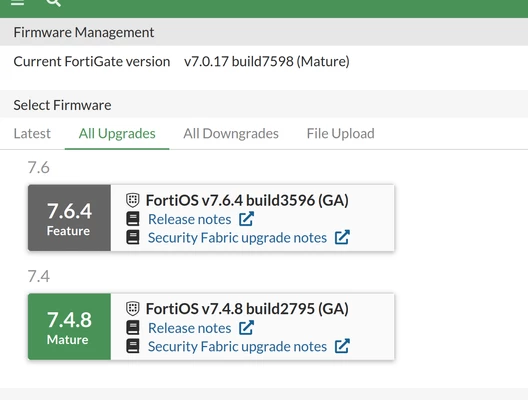

I recently purchased a Fortigate 50G, and the firmware on the device is v7.0.17 build7598 (Mature)
I see possibility of upgrading beyond 7.0.17 but it doesn't see to be possible through the GUI.

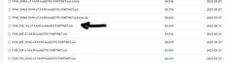

Also when I check the Firmware images available in Support section of Forticloud I don't find any firmware for 50G, I find them only for 50G-5G.
Any info how I can upgrade?

Best answer by jiahoong112
There is. In your firmware downloads on support.fortinet.com, browse to /FortiGate/v7.00/7.4/7.4.8 and search for
FGT_50G-v7.4.8.M-build2795-FORTINET.out
FGT_50G_5G-v7.4.8.M-build2795-FORTINET.out
You'll see 2 types, for the regular 50G and for 50G-5G version

The issue is resolved. I found the image.
yhpp
October 2, 2025
Hi @rouzbeha
Could you tell us which one worked for you?
