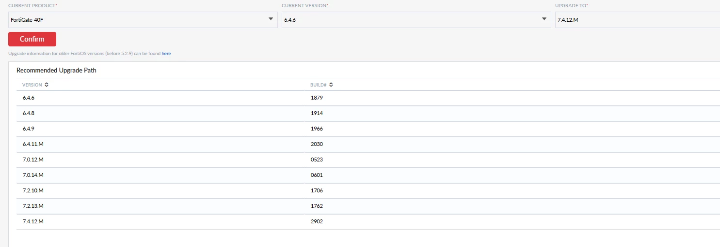

Hi
I’ve one Fortigate 40F with firmware version v6.4.6 build6083 (GA).
What is the suggested upgrade path. The target is to reach  v7.4.12(Mature)
Thanks
Venkat

Follow this upgrade path
