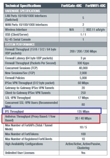

    It would help us a lot if you provided more information on how your 40C is setup, such as firmware, whether you have any soft switches setup, have tested for duplex/speed mismatch, CPU/memory usage, tailored UTM features to the traffic (e.g. separate firewall policies covering web traffic, DNS, email traffic, NTP, other, etc.)
    The specs for the 40C outline the throughput performance limits placed on the 40C with IPS/antivirus features enabled.   While it may be possible that your network has outgrown your 40C, limiting/tailoring the IPS/App control/antivirus policies to the traffic can go a long way.  (E.g. you don't want your fgt's IPS policy scanning for linux/MAC exploits if the traffic is windows-PC based traffic only.)
