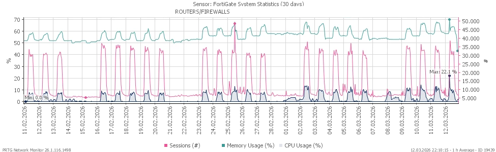

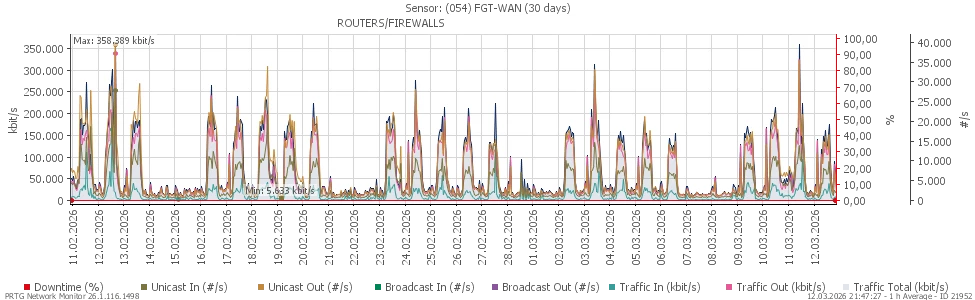

- 3 Gbit internet connectivity does not mean 3 Gbit of traffic. The average daily traffic is around 300 Mbit/s. Please see the attached graph from our monitoring.
WAN traffic:
Performance (CPU, Memory, Sessions):
- No, there has been no increase in traffic volume or change in the type of traffic. Everything has remained constant.
Thank you for your clarification. This information is crucial and prevents any misunderstanding.
358Mbit/s is the accurate peak traffic.

|-- Performance (CPU, Memory, Sessions):
These 2 pieces of information are also very important.
It would be even better if we could provide an accurate daily traffic(Only one day is needed, and the exact time need be provided.), so we could clearly see when the daily traffic peak begins, what the exact peak traffic volume is, the corresponding memory and CPU consumption, and the CC and CPS.
The image shows that memory usage consistently stays above 50%, reaching 60% to 70% during peak periods. This is the performance on V7.4.11GA.
On average, CPU usage is between 40% and 50%.
The overall traffic is approximately between 50M and 350M.
One predictable behavior is that with UTM enabled, memory consumption in version 7.6 will be approximately 5% to 7% higher than in version 7.4, due to the addition of new features and changes to the IPS engine.
Therefore, memory usage is expected to increase from 50% to around 55%, even with the initial memory usage. The maximum expected memory consumption is approximately 75%, assuming everything goes smoothly.
It is obvious that one of the processes is malfunctioning and consuming excessive memory. At this time, we are unable to obtain the specific process and the root cause through the provided logs and information.  === > This is the clue we need to find so that we can assign the problem to the appropriate DEV team, such as the IPS team, the AV team, or other relevant and accurate DEVs to provide support.  We need to know precisely whether this is the expected behavior or if a certain process actually has a bug causing abnormal memory consumption.
