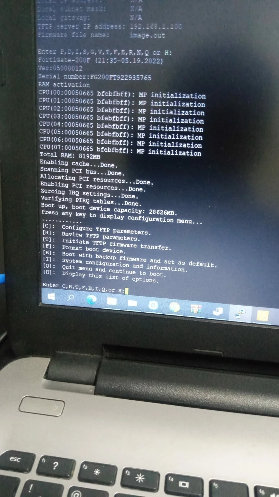

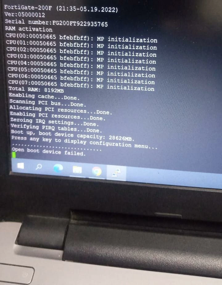

My fortigate firmware broken or corrupt. How can I reinstall new firmware to fortigate 200f. Please help

With that being said, one thing you can do is fresh-install firmware to the FortiGate using TFTP. These Community KB articles are helpful for this task (and you can find more articles like this by searching our Fortinet Community site:

I'd suggest formatting the bootdevice via bootloader (requires serial console) to make sure the filesystem is good and then uploading new firmware via ftp via bootloader. However you will need to have access to the support portal to get firmware images (requires an account plus at least one registered device with valid FortiCare license).
