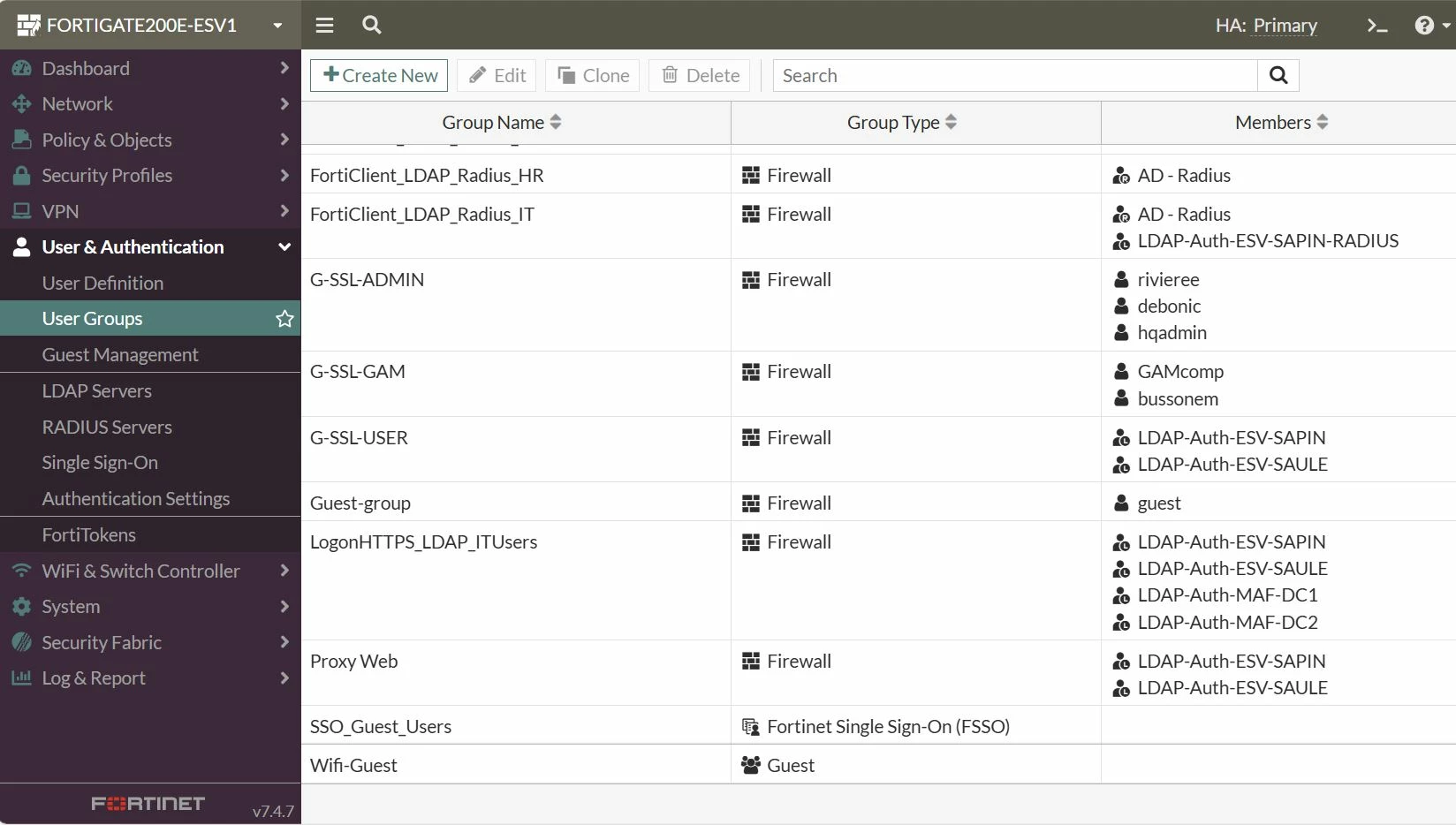

I made a user group "G-SSL-ADMIN" with the users allowed
Screen 1

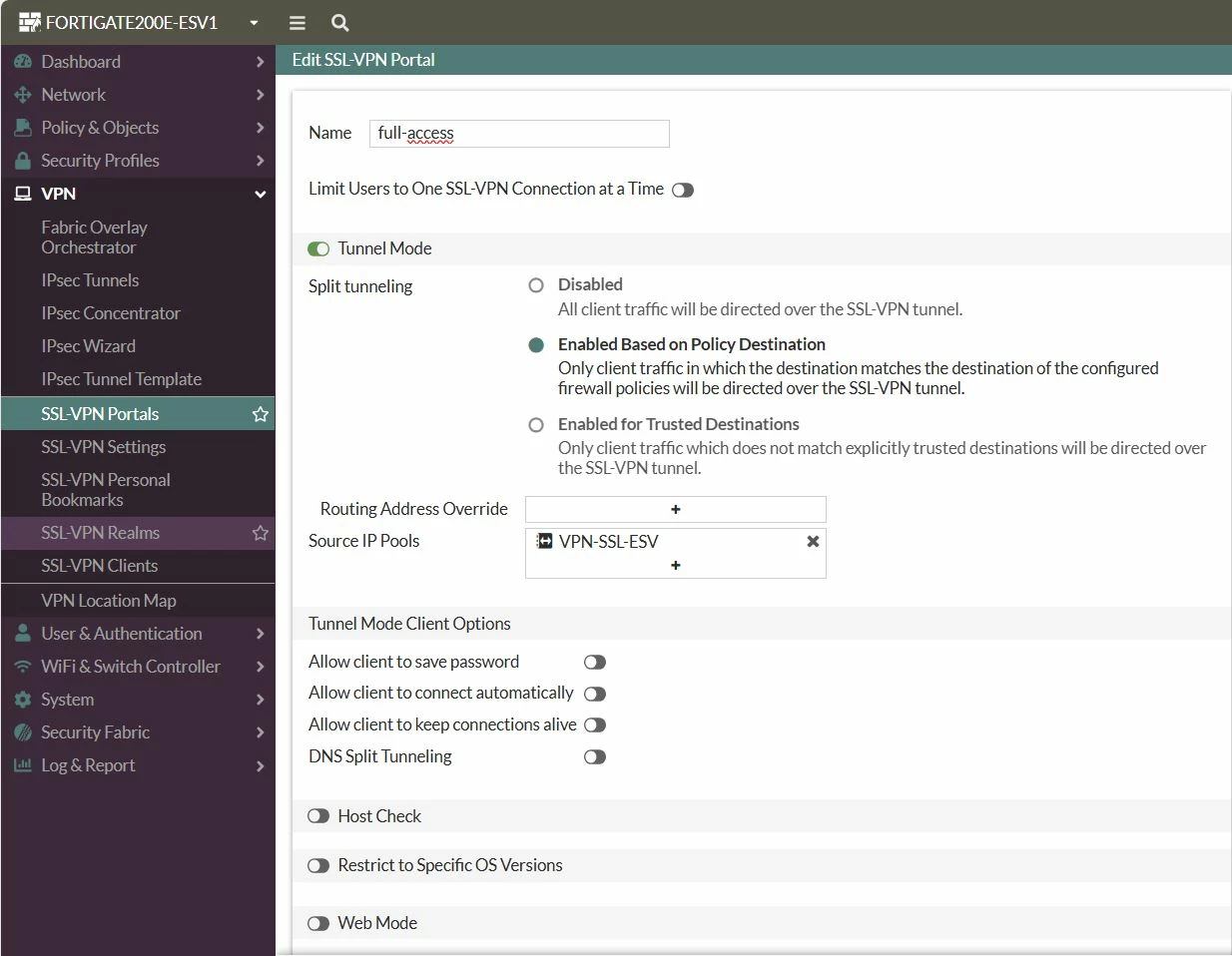

On SSL-VPN Portals i made a full access group
Screen 2

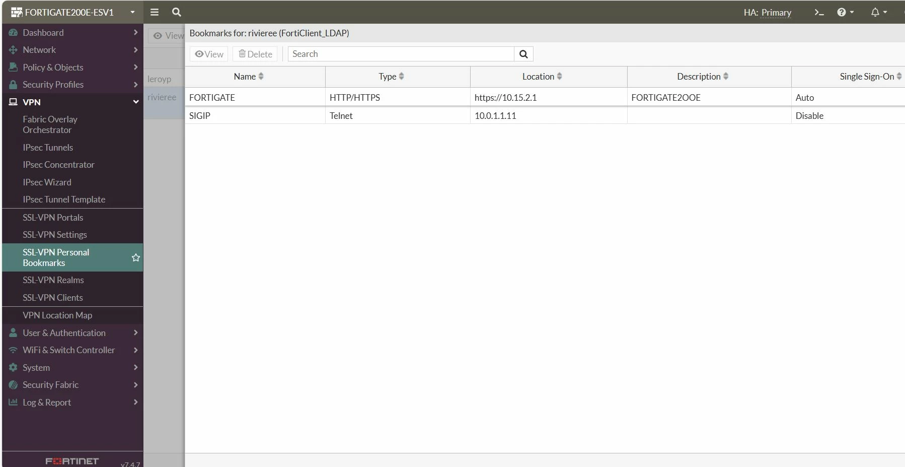

SSL-VPN Personal Bookmarks.
Someone has an idea ?

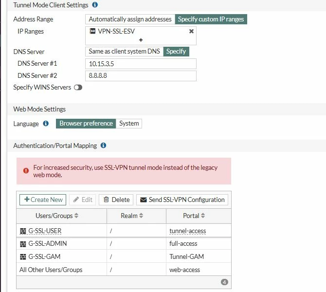

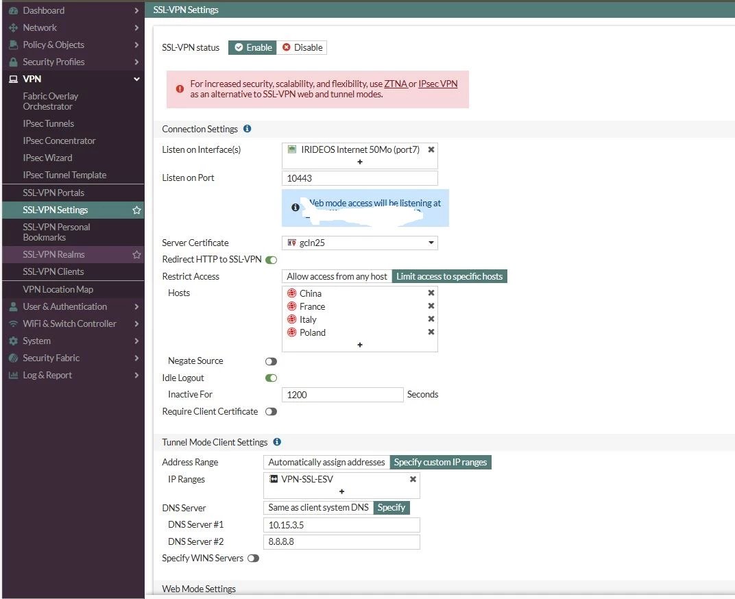

Can you please share screenshot of SSL VPN setting and configured policy?

Please share configured policy screenshot. I just want to verify if destination and services are allowed in policy or not.

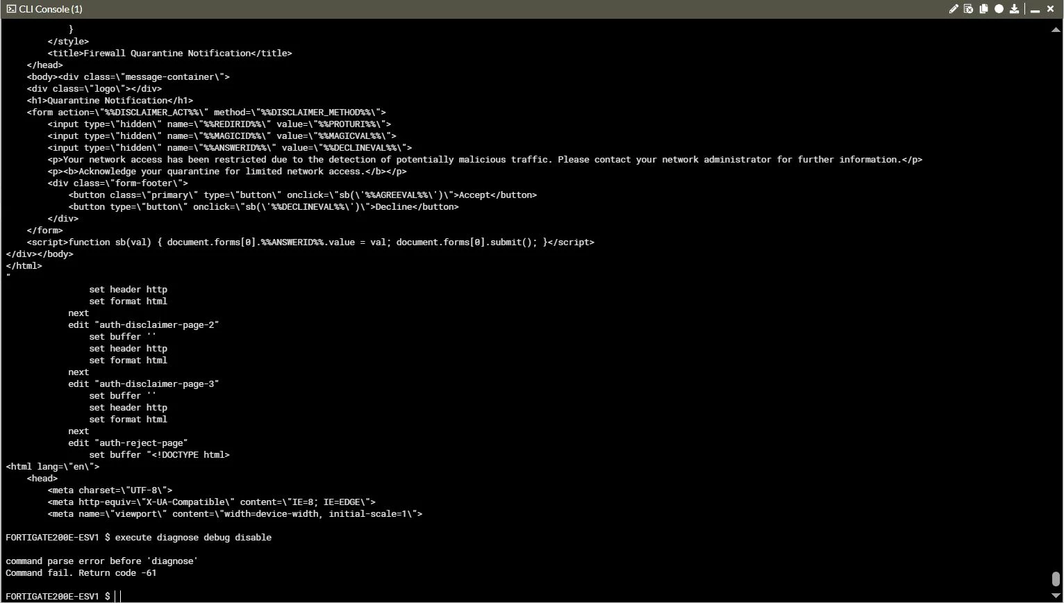

You can enable the following debug logs and test again.
diagnose debug disable
diagnose debug reset
diagnose debug cons time enable
diag vpn ssl debug-filter src-addr4 x.x.x.x (Replace x.x.x.x with the IP address of the PC connected to the SSL VPN)
diagnose debug app sslvpn -1
diagnose debug enable
***********reproduce the issue**********

I'm logged on the firewall CLI Console there is no ssh or telnet enable.
When i type : diagnose debug disable

I can't make any diagnostic, because the command are not working :
