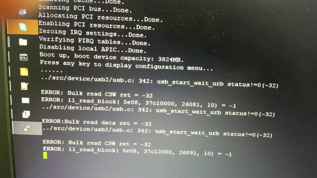

Dear All,
- I have firewall fortigate 200b run Firmware Version v5.2.10,build742. On a beautiful day it not working, I have restart it by turn off and turn on the power. After that it can't start up and show message error as below. Please help me, How to fix it and root cause of this issue. Thank All !

    November 10, 2017
    You might  need to do a reformat  and tftp upload with new firmware
    Ken
