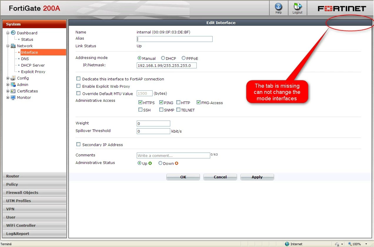

hi guys
I recently bought two FortiGate 200A on ebay  for my own training and one of them the tab “changes mode” in internal interface web manager is missing . they have the same firmware  except bios is different 04000003 and 04000000 I notice that when you type get system status the line Internal Switch mode: interface is missing ?   can someone  please help me to resolve this problem ?
I do not know if its just the firmware are bad or the bios ?
The firmware is FGT_200A-v400-build0689-FORTINET.out
the other model works correctly
thanks

    g_rayan
    g_rayanAuthor
    May 10, 2016
    hi jeff
    I'll show you with Capture Desktop you better understand my problem this is the bad one
    and the good the tab is in its place
    Jeff_FTNT
    May 10, 2016
    You may use CLI: dia sys checkused  system.interface.name internal
    If internal interface is used by policy/static route, you may need delete it firstly. Then the icon will show up.
    g_rayan
    g_rayanAuthor
    May 11, 2016
    hi
    when I type :dia sys checkused  system.interface.name internal
    Forti-2 #
    I return to the prompt and nothing is happening i did execute reboot but it is always the same no tab
    I remove the rule in policy
