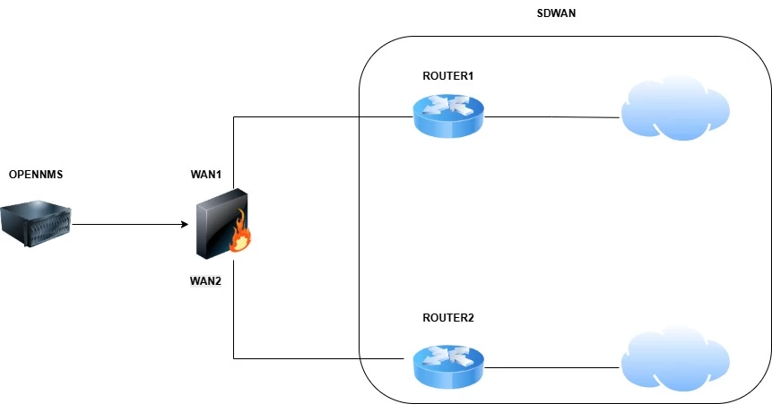

Hi,
on Fortigate 1100e (7.4.9) we set up an SDWAN like this
We would OpenNMS pinging a public ip (8.8.8.8) through the line of ROUTER1 and another public IP (8.8.4.4) through the line of ROUTER2. So we set up these policy routes:
SOURCE         DESTINATION      GATEWAY
OPENNMS      8.8.8.8                  ROUTER1
OPENNMS      8.8.4.4                  ROUTER2
In static routes we have:
0.0.0.0/0      SDWAN
In SDWAN policy we have the default (selected members by source IP)
When both interfaces WAN1 and WAN2 are up all works, but:
  • If we disable WAN2 interface both ping works
  • If we disable WAN1 interface both ping not works
when both interface are up, traceroute show that the routes are correct  (the ping towards 8.8.8.8 choose WAN1 , while the pings toward 8.8.4.4 choose WAN2)
Any ideas?
Thanks
Best answer by pacionet
Sorry
I found the problem.
I used a wrong NAT on firewall Policy
We need 2 policy:
OpenNMS -> 8.8.8.8 -> NAT WAN1
OpenNMS -> 8.8.4.4 -> NAT WAN2
Thanks !
1 reply
