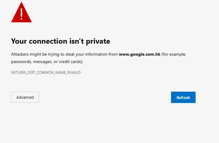

Hi experts,
I am experiencing a certificate warning when users browse HTTPS websites such as Google.
The browser shows:
Your connection isn’t private
NET::ERR_CERT_COMMON_NAME_INVALID
Device Details:
  • Model: FortiGate 100E
  • Firmware: v6.2.16 build1392 (GA)
  • SSL Inspection Mode: Deep inspection (certificate inspection using Fortinet_CA_SSL)
  • Web Filter: Enabled
  • FortiGate certificate is already imported into client trusted root store
  • FortiGate DNS cache has been flushed (diagnose test application dnsproxy 8)
  • Tested browsers: Chrome, Edge (same issue)
Troubleshooting Done:
  • Verified system time on FortiGate and client
  • Flushed DNS cache on FortiGate and PC
  • Imported Fortinet_CA_SSL into Windows and Chrome store
  • Checked if FortiGate is presenting a mismatched CN (shows FortiGate CA instead of Google CN)
Question:
Is this a known issue with v6.2.16 build1392?
Any official Fortinet patch or workaround to fix SSL deep inspection mismatch?image.png

Hi FNAC
In normal working, the DPI profile sets the certificate CN to the requested FQDN.
  • Did you configure an authentication portal in your FGT? If so then disable it and redo the test.
  • Can you rebuild a DPI profile from scratch, use it in your firewall rule and redo the test?
