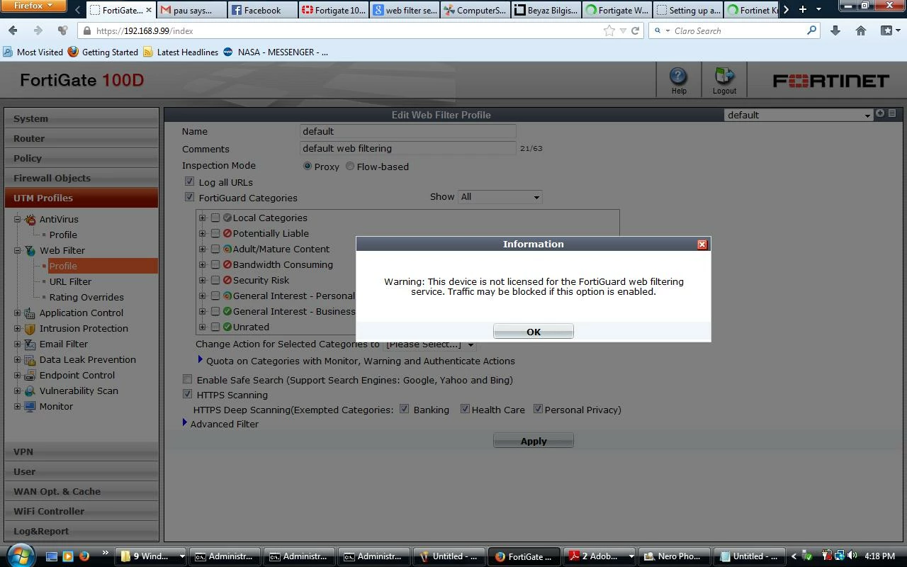

    hi all, i have configured this fortigate 100D. i directed my laptop to one of its port then i can access anything on the internet. how ever if i connect my switch to the fortinet port. my pc is blocked to any sites and has this error: pls help . thanks

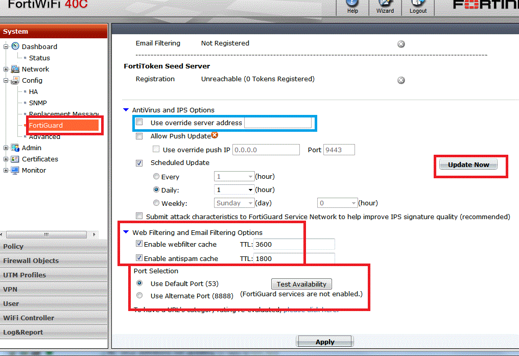

    Your attached pic shows you have FortiGuard web filtering enabled on one of the firewall policies, but the 100D can not contact/reach the FortiGuard servers. Make sure the 100D' s internal DNS setting is configured with a proper DNS server IP addresses (System/Network/DNS/). Fortigate devices need a fully functional DNS setting for FortiGuard services to work and also a valid subscription. If the 200D has both, you can force the Fortigate to reestablish a connection to the FortiGuard servers by going to /System/Config/FortiGuard/AntiVirus and IPS Options then clicking on Update Now. After this, click on the " Test Availability" under the " ...Web Filtering and Email Filtering Options" . This is for 4.0 MR 3 firmware.

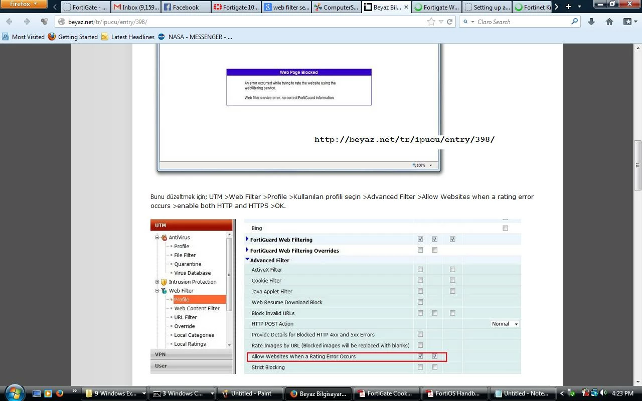

    hi sir, thanks for your reply.. regarding the error which i post lately. i come up to this solution, then i can access everything on the internet.

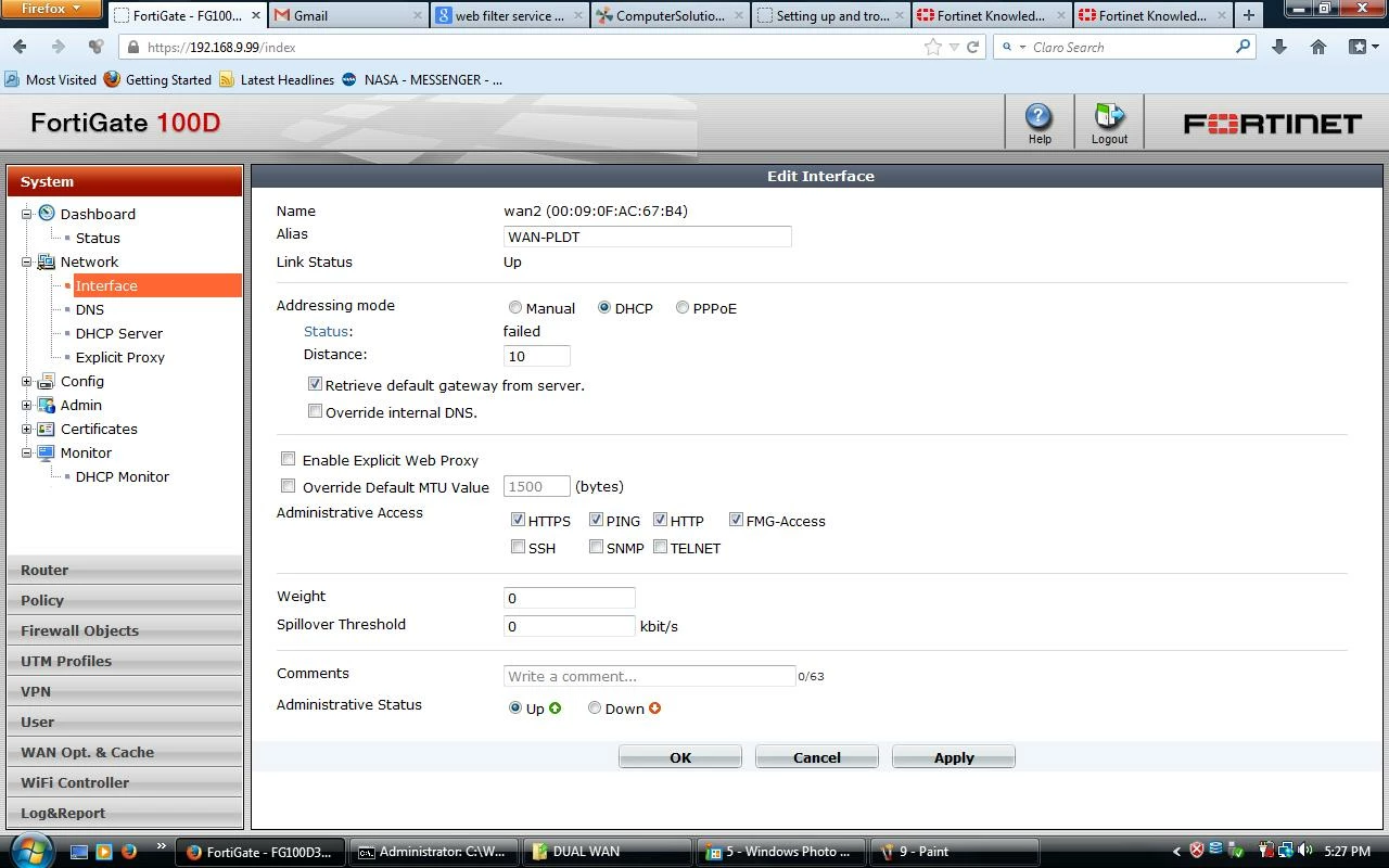

    how ever.. i have a problem: 1. if i try to create wan 2 for dual wan, the status for both DHCP and PPPoE fails

    Take rwpatterson advice walk b4 running. Now in your dual wan let' s work on that 1st. Are these interfaces connected to your provider via static dhcp or pppoe since you mention the later 2? if it' s via DHCP and PPPoE and your retrieving the default-gateway from the provider what does your route table looking from the routing monitor? If your static addressing these interfaces ( more preferred setup imho ) than once again do you have the correct addresses? What does your route table look like from the monitor. next can you ping the gateways from the fortinet directly ( go to the console ' execute ping x.x.x.x ' where x.x.x.x is your next-hop-gateways ) Get your dual wan setup 1st b4 trying to enable any profiles with webfiltering.
