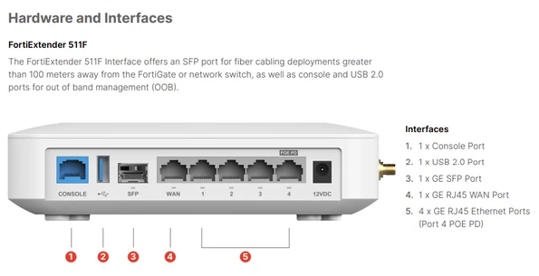

Hello @Beneto ,
yes FortiExtender supports WAN connectivity options with an Ethernet WAN port. So you can deploy it that way.
Check the data sheet for more detailed information:
Regarding the managing, in addition to FortiManager extender function i would also suggest checking FortiEdge cloud:
FortiEdge Cloud is a hosted cloud-based management platform for secure LAN edge (FortiSwitch and FortiAP), and FortiExtender 5G/LTE gateways, offering zero-touch deployment, configuration management, reporting, and analytics for standalone LAN and WAN gateway extension deployments.
