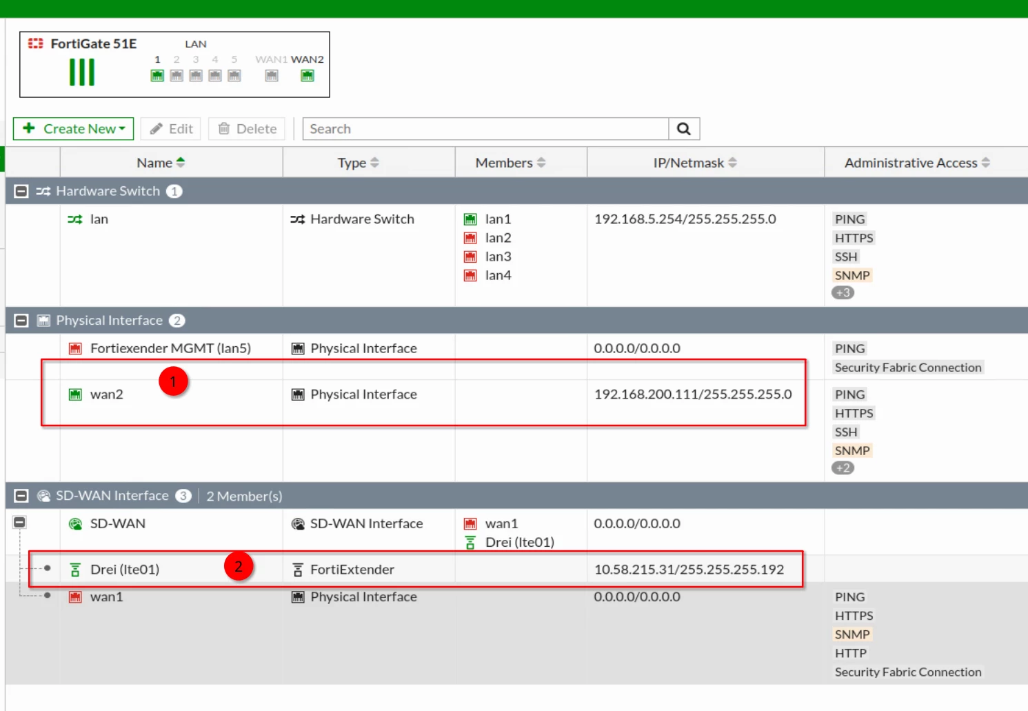

On both it is working fine. With and without  ip-passthrough (capwap). So the goal is in this situation "Fortigate 51E + Fortiexender 201E". But there is big difference between the fortiOS 6.2 and 7.4. On 6.2 i can't find an option for access directly to the fortigate for management over WAN. Please see the attached screenshot.
1 = Capwap to the fortiexender
2 = the generated lte interface
if i open 2 i can only see the serial from the extender. On the fortigate 60E with OS 7.4.x i can to the same like an normal wan interface. Does it work differently with the 51E? And yes i know with this public ip it will not work (happynet), but if I can't configure it? Or are the settings of WAN2 valid for the release of the Fortiagte Interace?

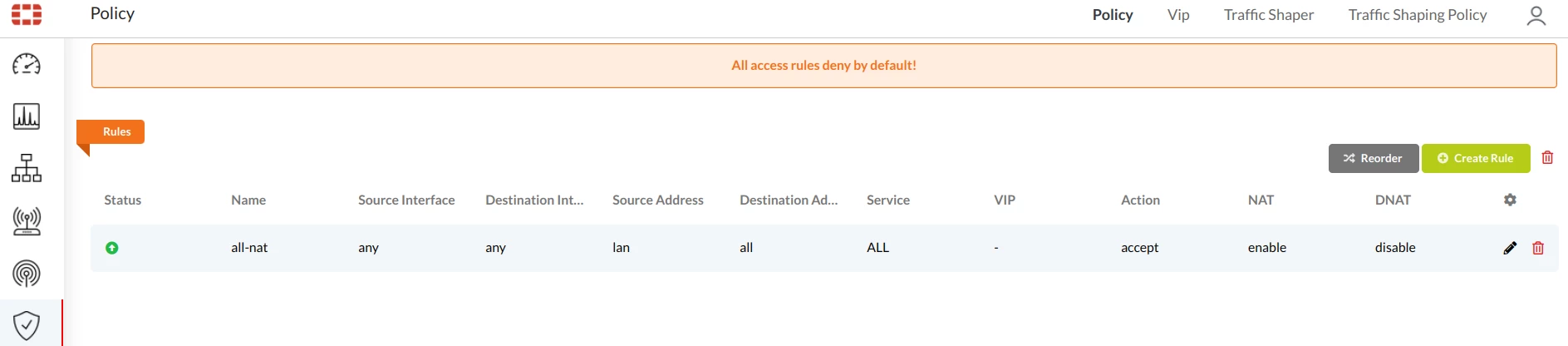

Also the firewall policy at the fortiexender is only one from lan to the Internet.
