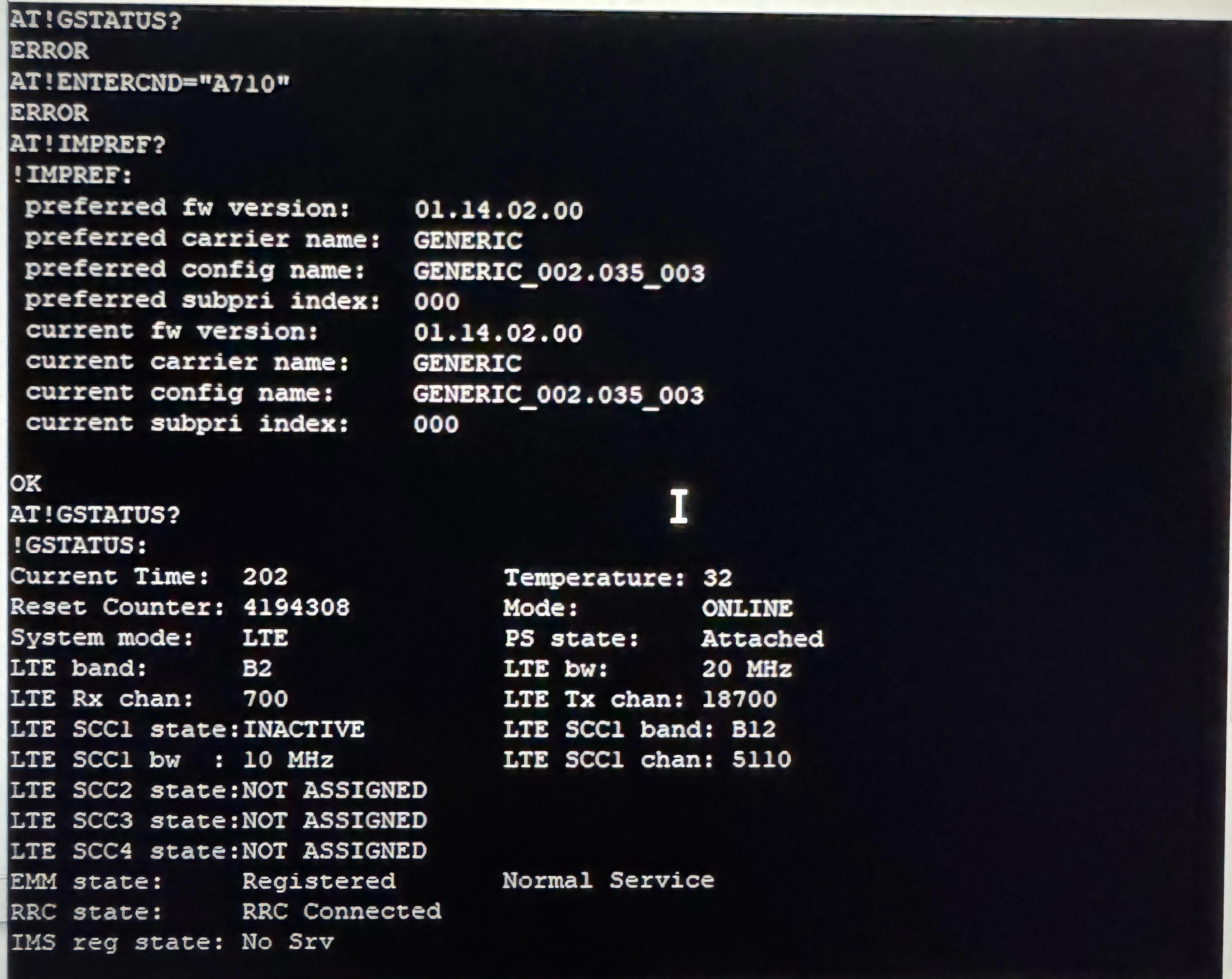

I troubleshot the device last night and found some more strange behavior. The device in question refuses to update to the latest generic firmware, even after double flashes the best I could get it was to an earlier release for PRI / firmware.
I did want to get everyone’s feedback on the attached screenshot. This is from the Windows 10 machine - my biggest concern is the rest counter with a total of 4,194,308 resets and counting.
I have somewhat stabilized the device using <
At!usbcomp=1,3,1009> then uninstalling any / all drivers.  Although I have lost my COM ports (assuming a composition change) the device has not bugchecked since and has been running relatively stable (one network connectivity freeze.)
interestingly when I attempted different external USB modems - I have the same behavior from the ATT 840u, which I believe is also a Sierra chipset, but no issues with an inseego usb800.
I am also able to get my GNSS data back via ublox generic drivers.
