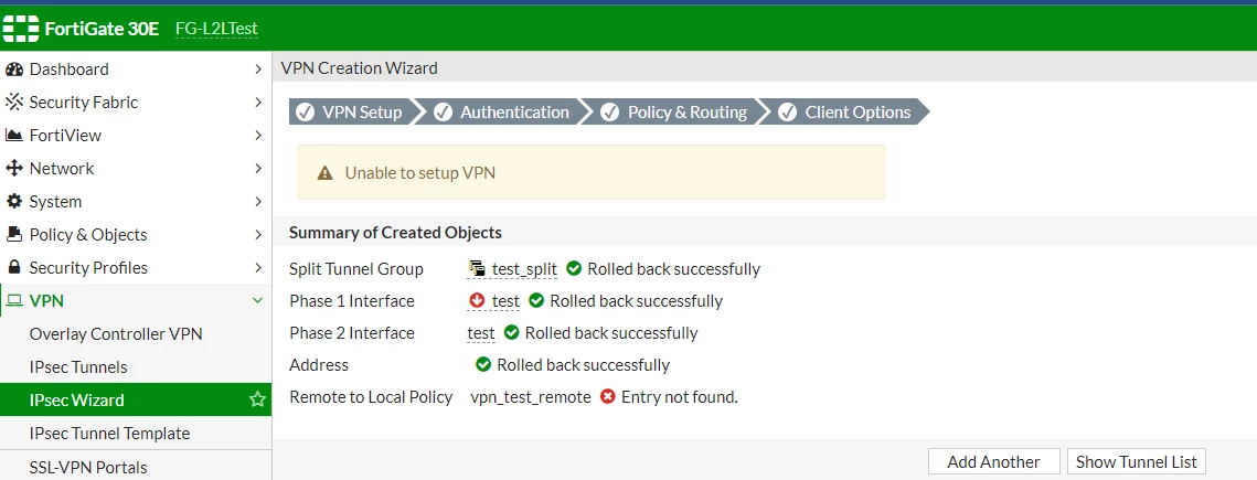

Greetings, through the wizard I am trying to create remote access to my Fortigate 30E with firmware 6.2.15.
In the Remote to Local Policy field I receive the result Entry not found.
Do you have any advice on this?

Hi @SupportoSaas,
Can you check the address object and make sure it is configured with right interface?
Regards,
adimailig
November 17, 2023
@SupportoSaas
I encountered this before and the issue was conflict on address object associated interface.
Please check address object "test_range" or "test_split" and confirm if it is associated to your LAN interface. Much better if you remove associated interface for testing as well.
Thank you.
mle2802
November 17, 2023
Hi @SupportoSaas,
It could be the duplicate address range and subnet. Can you please double check those information?

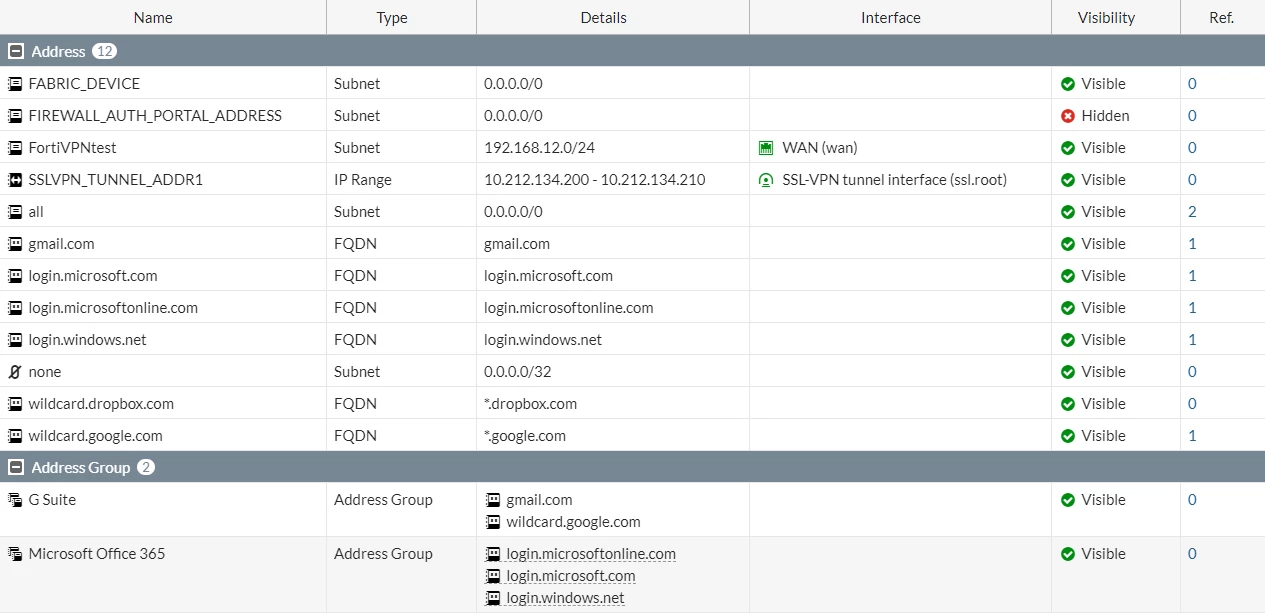

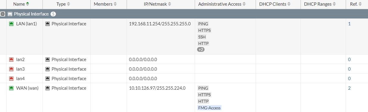

SupportoSaas
November 22, 2023
I just carried out the checks you suggested and I don't notice any duplicate addresses or incorrectly associated interfaces. I show you the screens of the interfaces and addresses. Can you think of anything else?
