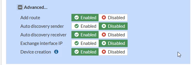

I have tried enabling/disabling add route, auto discovery sender, autodiscovery receiver, exchange interact IP, adding a static route to one of the remote internal networks as a test, and setting the client address range to be on the same IP range as the internal LAN.

The only other thing I needed to do was make sure Add Route and Auto discovery receiver were enabled on the remote VPN settings.
