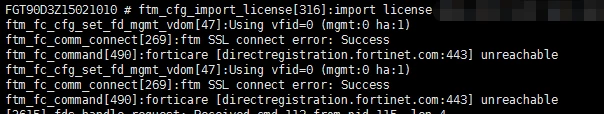

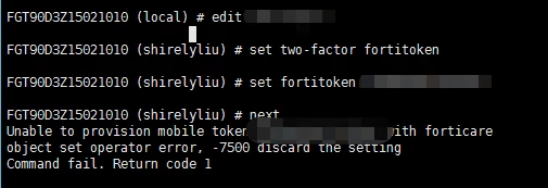

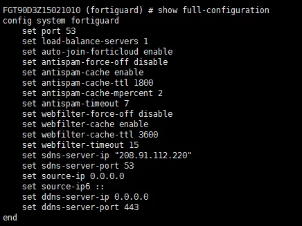

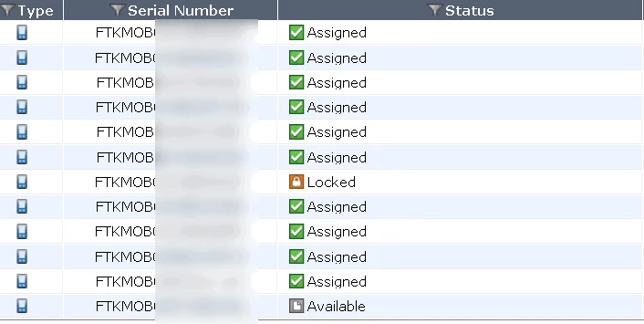

After I unassign Fortitoken, this token shows locked that I can't assign it to others, I tried to unlock it but it shows as Error in CTL, I found that all my Fortitoken can't be assigned or imported because FortiCare unreachable, and my settings don't have "fortiguard-anycast & protocol", please help me. FortiGate

June 20, 2022
Hey Rroy,
do you still have issues with assigning tokens?
Regarding the anycast/protocol settings, they are only available in higher firmware versions (assuming you are on 5.4 as your post is tagged).

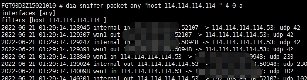

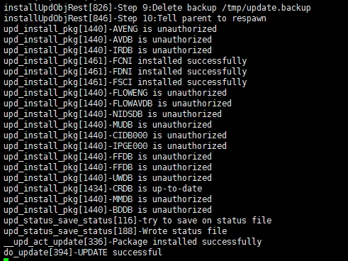

please provide the below commands
Putty1:
dia debug app update -1
dia de en
execute update-now
Putty2:
dia sniffer packet any "host x.x.x.x " 4 0 a
x.x.x.x ip address generating putty1
Please share both logs and give us update.
-Naveen

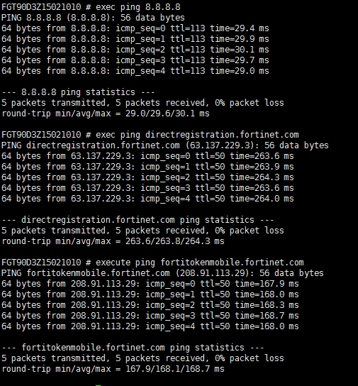

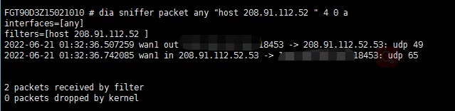

Rroy
RroyAuthor
June 21, 2022
Hi Naveen
 Please check the picture above, when I use a foreign IP this test will be very slow, location China.
Cloudmax-Penny
June 27, 2022
Hello:
We also get the same problem after changing user's token infomation.
We had tried this posted info and it might get the following messages.
fds_https.c[593] fds_ctx_set_addr: server: 173.243.138.67:443
fds_svr_core.c[169] fds_svr_default_pickup_server: fdni: 173.243.138.67:443
fds_command.c[300] fds_send_reply: Sending 736 bytes data.
fds_command.c[324] fds_send_reply: send reply failed: req-1, Connection refused
fds_command.c[920] upd_parse_res: no IMLT object in response
ftm_fc_command[492]:forticare [directregistration.fortinet.com:443] unreachable

We have 3 Fortigate 310B and they also have fortitoken license.
The original token has shown the locked status and can't change status in CLI.
Please help us to resolve the problem.

warshad
June 27, 2022
Dear Roy,
Please be aware that 5.4 is out of support. The same goes actually for the 5.6 and in September the 6.0 will also be end of support. Please plan an upgrade.
The Anycast related changes were implemented in the 6.4.3
