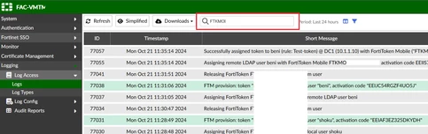

Are all the tokens in the Pending status not showing a User? What is the firmware version that is currently running?
You can check the token assignment history in the Logs (using the serial):

I have checked logs and found out 2 users with wrong email addresses. The log messages repeated every hour (the sync rule timer). Customer fixed the addresses in AD, I cleared the pending status of the tokens and for next 48 hours none of the unassigned tokens went to the pending status. This solved the issue and thanks for pointing me to the logs.
Anyway, I found it strange,that FAC pulled the users from AD, assigned them a token (which has 30 days activation period), then failed to send the activation emails and decided to solve this automatically by assigning another token within the synchronization period just to fail again and again...
