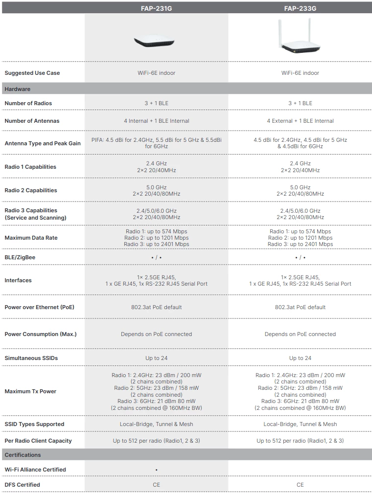

As long as you maintain your FAP and FGT at the recommended/mature firmware version, you will have a good WiFi with no issue.
Here is a good starting point to compare FortiAP products.
https://www.fortinet.com/content/dam/fortinet/assets/data-sheets/Fortinet_Wireless_Product_Matrix.pdf
(I see 231G and 233G are almost the same)

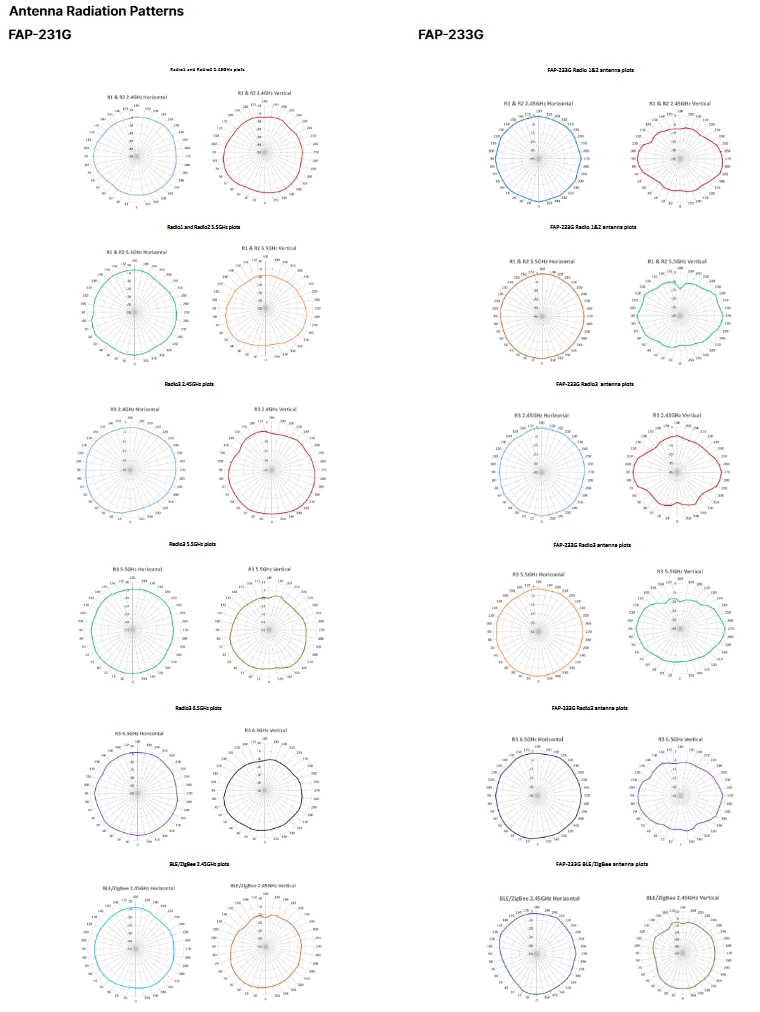

This is what I have seen as well. I have checked the documentation (like in your picture) and have seen not so many differences. I see bigger differences when checking the Antenna Radiation Patterns... So I thought I just would like to get some experience from persons that have bought the 231g and then switched over to 233g or perhaps 4xx models... and then their reasons why they switched to another model. :) If it is interesting here are the Antenna Radiation Patterns comparisions for the 231g and 233g models:
