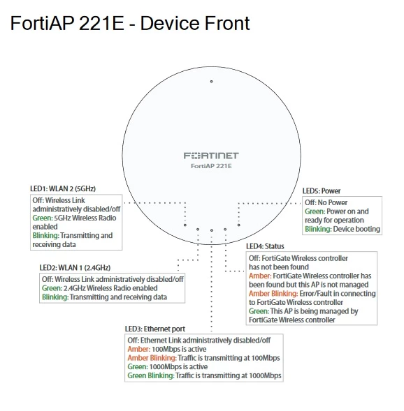

    Do the APs show up in the Managed FortiAPs section but greyed out?  Are they assigned static IP addresses and/or getting IP address via DHCP?
    Check the LEDs (see pic below as an example).  The Power, Status and Ethernet LEDs should be on.  If the APs have valid IPs but can not see/detect the fgt (wifi controller) than you may need setup one of the three options (in the AP) for detecting the wifi controller.
    Aside from the above, the firmware upgrade process may "patch" or assign a temp FortiAP profile to the the APs - check/confirm they look ok, including actual opening the AP profiles to see that the SSIDs are assigned/configured.  You may see profiles tagged with "tmp" prefixes.
    Toshi_Esumi
    September 25, 2019
    Just a note: The LED indications David posted might not exactly match your 221E's depeding on Gen1 or Gen2 version you got. Gen2 doesn't have Amber LEDs, but all Green LEDs. And they replaced "Status" with "Bluetooth Status" LED. But the rest like patterns should be the same.
