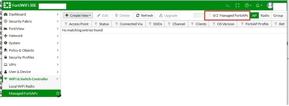

The other time is when the fgt has reached the hardware max limit for controlling APs devices.   For example, my little 30E can only control 2 x APs.

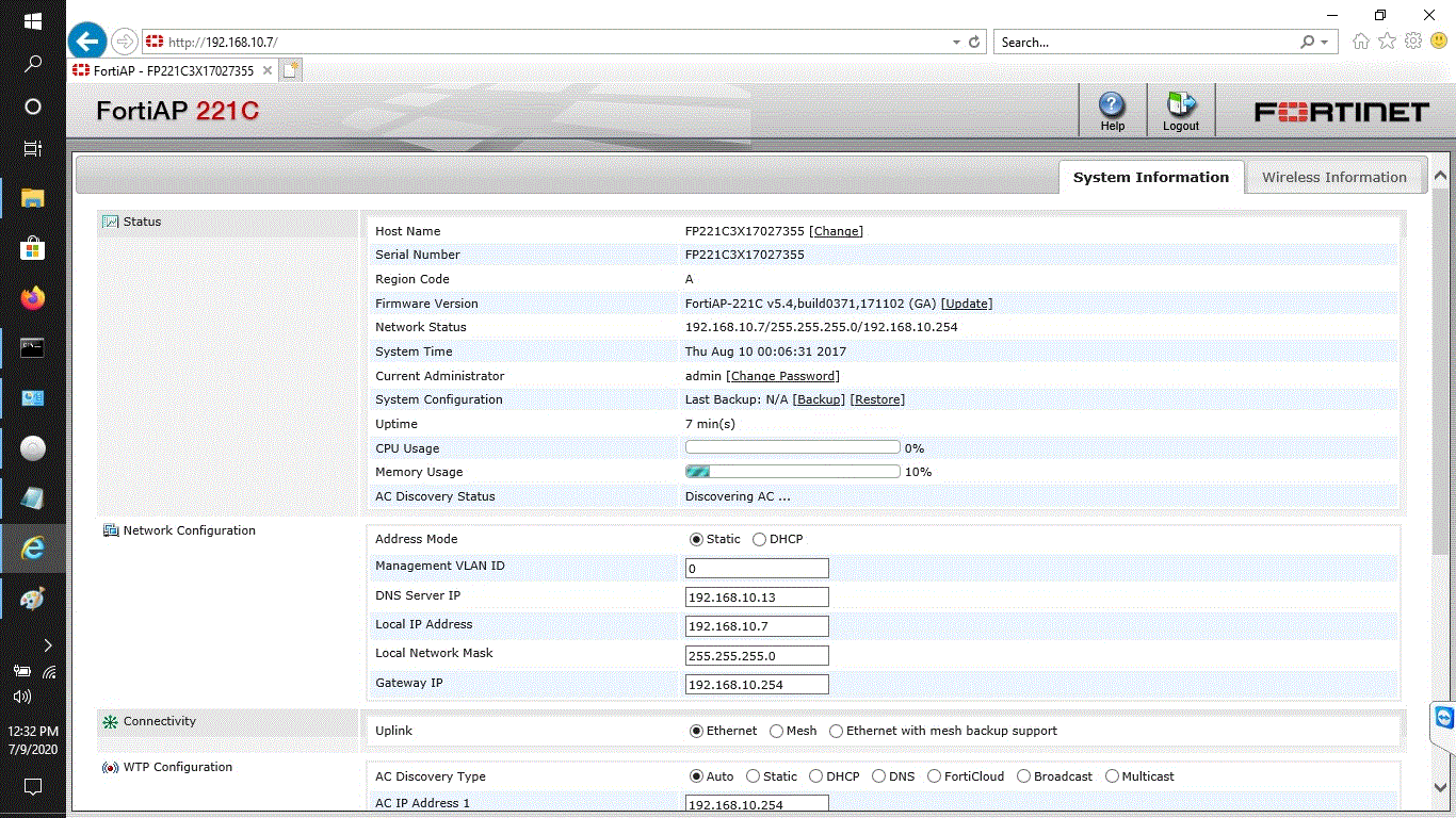

Thanks for your help...I can access the GUI via a browser.  The GUI presents the login page...after entering the username/password (admin/null), the FAP221 console flashes and the login page is presented again.  Suggestions?

Try changing ALLOW_HTTPS to 1 (for testing only).  Then see if you can log into the GUI.  Try using an alternate browser.

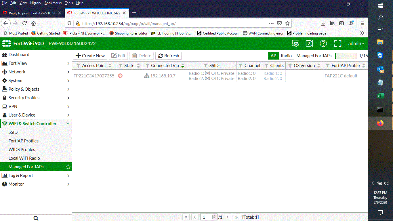

Your suggestion to change the browser helped...Using Internet Exployer, I can access the FAP221 control panels.  Now the question is why doesn't the FAP221 connect to the Firewall controller.
Below are screenshots of the firewall and ac controllers:

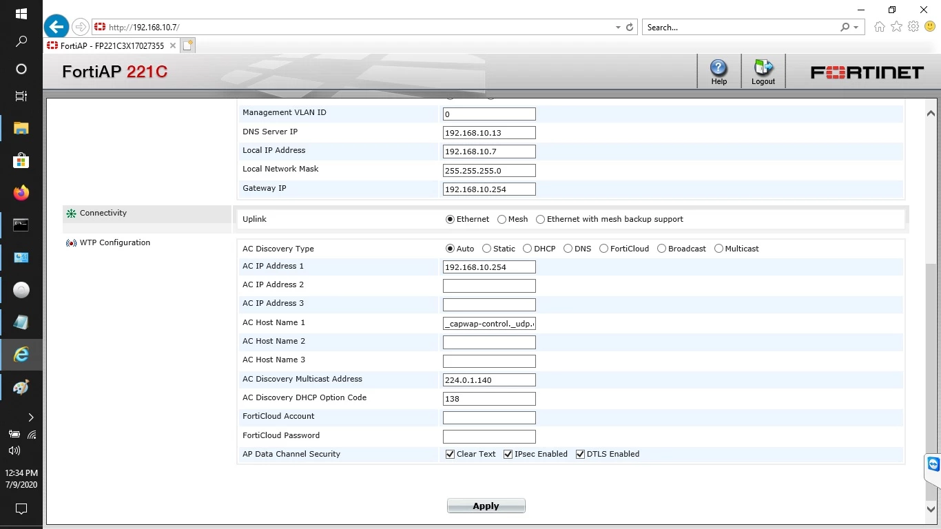

July 9, 2020
AP Control panel #2:
