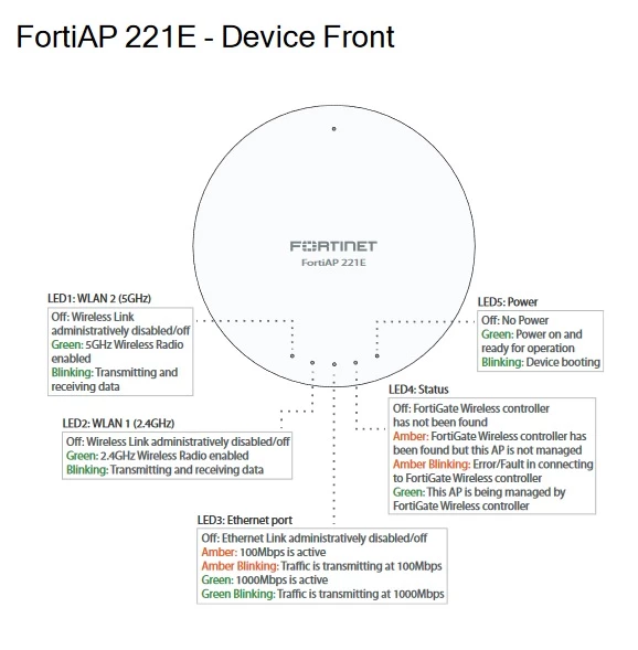

    If the firmware upgrade was initiated from a fgt (wifi controller) side, then it may be possible the the fgt is still trying to force an upgrade on the AP.  Trying deauthorizing the AP (from the fgt) and see if the AP stays online without rebooting.  Following this, determine what IP address has been assigned to the AP and log into the Ap's GUI.  From there you should able to determine the issue/cause.
    There appears to be a feature option that causes the fgt (wifi controller) to push down a firmware update once an AP has been detected/comes online.  I think in my case with a 321E, I had to contact support who had me try several things, but in the end I had to RMA the device.
    The following pic shows what the LEDS mean/do on the AP.
