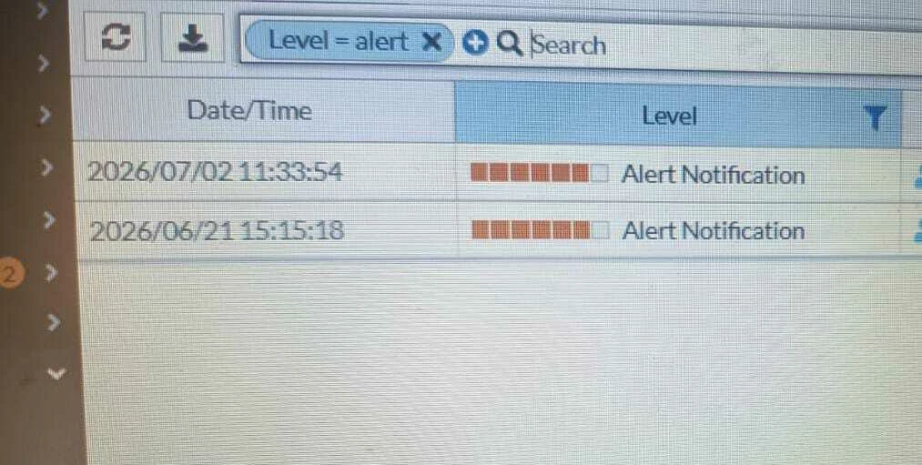

Hello everyone,
I am using a FortiGate 40F running FortiOS 7.4.12.
I would like to know if there is any supported or unsupported method to prevent the FortiGate from saving Alert, Error, and Critical logs in the local memory.
My goal is to stop these logs from being written to the internal log storage, not just hide them in the GUI or change their display.
Has anyone found a solution, workaround, hidden CLI command, or TAC recommendation that can completely prevent these logs from being stored locally?
Any help or experience would be greatly appreciated.
Thank you.

I need to stop save these logs

Hi ​@ahmadking22
The log severity filter in FortiOS works on an inclusive threshold basis. The default severity is information, which means all logs at the information level and above (including notification, warning, error, critical, alert, and emergency) are logged.
The severity levels are:
emergency
alert
critical
error
warning
notification
information
debug
Setting the severity to a higher number (e.g., error) would only log error, critical, alert, and emergency — it would not exclude Alert/Error/Critical logs.
While you cannot disable Alert/Error/Critical logs entirely, you can use free-style log filtering  to exclude specific log messages based on criteria such as logid.
config log memory filter
config free-style
set category event
set filter "logid 0100041001"
set filter-type exclude
This allows you to exclude specific log messages by their unique logid, but you would need to identify and add each individual log ID you want to suppress
Thanks, Salon

​@ahmadking22
You can disable memory logging while navigating in the GUI to Log & Report → Log Settings → Local Logs and disable Memory logging.
This is because at 40F, a hard disk might not be present:
FGT40F # get hardware status
Model name: FortiGate-40F
Hard disk: not available    -------  no hdd to save logs but only memory (RAM)
USB Flash: not available
If this is the answer, please mark it as a solution to help others find it easily.
