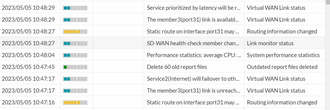

we have fortigate 1500D Series with HA configuration (active standby), currently port31 used by our company as uplink to ISP for 1Gbps connection link. The problem is sometimes that port become unreachable and down for several seconds from the event log it show like this :

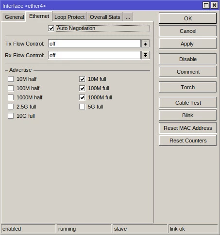

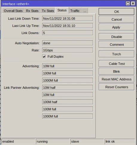

from ISP side using mikrotik router :
statusstatus
link speed option :
tthrilok
May 8, 2023
hi Bhamdani,
Could you check what is the destination you are trying to reach in the performance SLA where you called the interface port31. Once you double click on the log you should be able to see the performance SLA which is actually bringing the interface down.
Could you please check:
+ what is the destination you have defined in the performance SLA
+ what is the protocol you are using in the performance SLA
+ If it is HTTP, could you try with ICMP and also try to change the destination for any other public IP
Thank you!
bhamdani
bhamdaniAuthor
May 9, 2023
Hi @tthrilok,
Regarding performance SLA we set it as follow :
destination address: dns ip google -> 8.8.8.8
protocol : icmp
