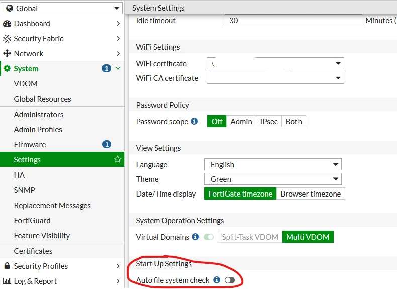

We enable this option for checking the disk before rebooting it:
After the device turned on again, we checked the logs and they were working correctly, the comand FG(global) # diagnose hardware test disk didnt show any fail.
