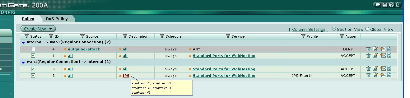

Hi All, I have Transparent mode settings for a FG200A-HD unit. I have WAN1 going to the DataCenter and INTERNAL going to my servers. I have a class of IP Addresses. 5 of those IPs belong to a specific client who needs IPS protection, primarily due to DoS attacks. Light attacks, yet still annoying. I' ve set up the UTM-IPS profile and it worked great and blocks away attackers. However, I belive I was setting up the Firewall rules incorrectly,. and I belive I had it such that the ENTIRE class was being put behind the IPS rule. The reason I believe this, is because Servers with IPs that were not supposed to be behind the IPS policy were all of sudden showing pages of ' Blocked because of IPS Attack' . And I know that these were not supposed to be ' enjoying' the IPS service. I know I can set the Addresses in a Group, .but for this ' exercise' I decided to have a single entry for each IP. I named them Starttech-1 through Starttech-5. Now, here is my confusion about the Firewall Policies order. Attached you can see the CURRENT setup: 1. Am I protecting the Starttech IPs? - assume the IPS profile is correct. (Yes/No) 2. Am I letting all other IPs go through with just ' regular' firewall services? - assume my policies are correct. (Yes/No). My previous Setup had the Firewall rule ID 3 BEFORE ID6 (as shown in my picture). I have just swapped them, so ID-6 is now showing First - so the picture is showing the Current status. 3. Is this how I should have it? 4. Was the previous order a mistake? (where ID-3 came before ID-6). Thanks for any input on this. -Sup.

    3 will never get hit because 6 comes before it and handles all the same systems included in 6... Policies are read/executed from the top down. (I am assuming that IPS group is included in ' all' ;)

    Yes that 100% correct. You always put the most specific rules before the least specific. Since you have a PP attach to that rule you could also pull the rule up in the monitor and see if it' s being matched. You will find nothing will show up for Policy ID #3.

    hey that looks great. You should take a instructor course ;) Now on the policy order, if you would look at what your originally post and the doc, the ordering is changed ( policy ID 3 & 6 ) Now if you review the attack log, the attack will logged the Policy ID that triggered that event. Lastly a off subject tip, you might need to trim and adjust your dos/ids signatures to reduce false positives. Good job and good luck, your doing it right.

    Thanks for the complements :) Did I set it right? Did I miss a step or otherwise need to make modification? Yes,. ID 3 & 6 were changed following the discussion in this thread, so that the CORRECT order is in the step-by-step document (as well as in the physical machine). I am still facing two issues: 1. For whatever reason, IPs that are in the ALL and not in the IPS group, are seeing " Blocked by IPS" messages. 2. High loads on the CPU of the box. The only thing I can think that might trigger the " Blocked by IPS" in the ALL policy/group (which shouldn' t happen) is actually related to the High Loads of the CPU, possibly due to an aggressive attack. Is that likely? Would FG300A be more resilient to attacks than the FG200A? Does it have a more powerful CPU that can handle higher loads? Or will FG300A handle same CPU load, just with a GB interface compared to the 100Mbit of the FG200A? I recieved a private msg from Ken with the following info in response to my problem: " I don' t see how? Unless the Protection Profile is enable for ips-sensors, the IDS/IPS is disable. Are your 100% sure it' s not permit and being deny with some " log traffic" enable?" Can you comment / explain me this further? What is the ' log traffic' he is referring to and how does that affect my setup? Last, " trim and adjust your dos/ids signatures to reduce false positives." How? or better ask: Which specifically? Today, I actually have only ONE server that is supposed to be behind the IPS protection. The other 20 servers are vanilla firewall. The settings that I have for that server seem to do the work for that server, but if you think I should change values, please provide me with suggested sample values. Thanks, -Sup.
