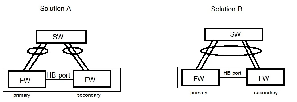

I'd like to know what is the best practice for FG HA Switch clustering.
How can I configure the LACP on switch with separate LACP group (Solution A)  or I can configure the same LACP group (Solution B) .
PS. Switch is a Cisco CoreSwitch and connected the LAN network.

I don't think Solution B would work. One FGT needs to terminate all LAG/LACP members from the switch.

Can we configure this command?
config system interface
    edit port1_port2
        set lacp-ha-slave disable
Toshi_Esumi
March 31, 2023
https://community.fortinet.com/t5/FortiGate/Technical-Tip-LACP-behavior-in-an-HA-cluster/ta-p/195163
Ok, I didn't know it's possible. I don't see much benefit of it though compared to have two separate LAGs and the switch distributes the same set of VLANs to both LAGs.
