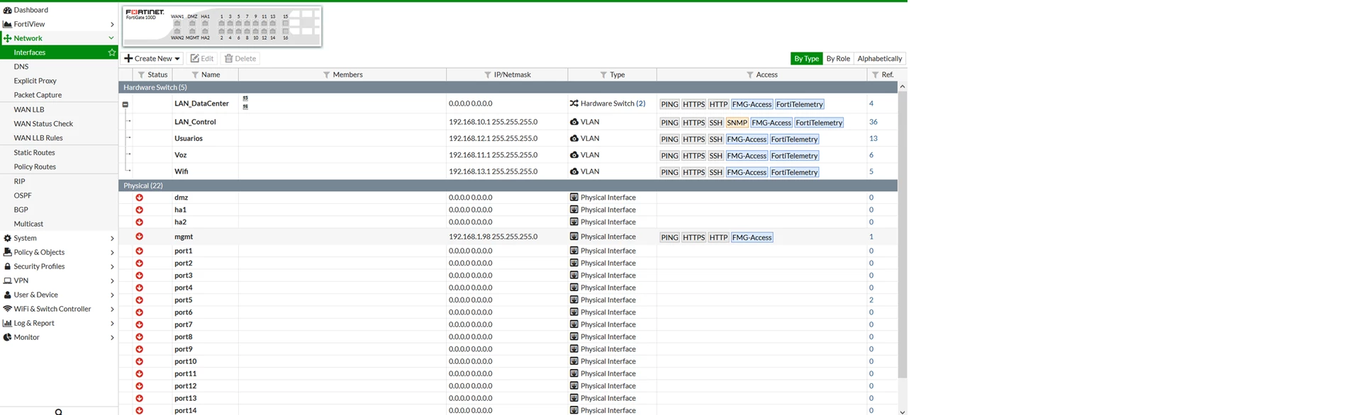

I have a FG-100D  in release  5.2.7 connected to a stack of S4810 Dell switches with an vlan switch configured with some vlans as shown below. I have configured DHCP in some of the vlan iterfaces. This is working normal. I have an spare 100D which I upgraded to 5.6.8 because the new Forticlient licence is not compatible with 5.2.7. However when I put this upgraded FG-100D into production the whole network behind gets down because it is not able to get DHCP from Fortigate. I uploaded the same configuration to the upgraded fortigate however it is not working. Any ideas about why DHCP is not working on this upgraded Fortigate??

     Thanks for replying Brian. yes it was. First we followed up an upgrade path suggested by Fortinet Technical support 5.2.7 > 5.2.9 5.2.9 > 5.4.4 5.4.4 > 5.4.5 5.4.5 > 5.6.2 5.6.2 > 5.6.6 5.6.6 > 6.0.4
    The we realized that it was not working as with 5.2.7. After reading your post, I stared over again with your suggested upgrade path, however when in 5.4.4 I realized that my VLAN switch I used to have in 5.2.7 - 5.2.9 dissapears in 5.4.4 and becomes a hardware switch which I believe is the issue. I am not a network expert but from what I know this should be a vlan switch or an 803ad aggregate in order to allow communication from my vlans to the Fortigate DHCP servers interfaces. Again this is working fine with the FG-100D in 5.2.7.
