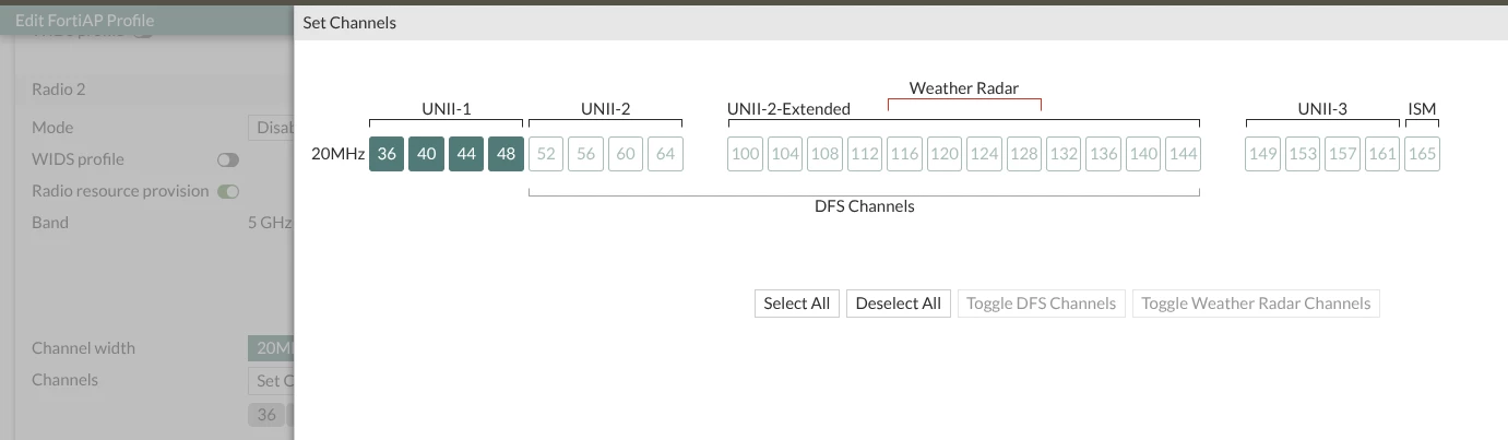

Sharing this in case others run into the same thing, and to ask whether
there is any plan to address it on the 7.4 branch.
## Summary
On a FortiAP-231K with region code "J" (Japan) managed by a FortiGate
running FortiOS 7.4.x, only W52 channels (36/40/44/48) are selectable
in the FortiAP Profile "Set Channels" screen.
All DFS channels (W53: 52-64, W56: 100-144) and UNII-3 are greyed out.
The "Toggle DFS Channels" and "Toggle Weather Radar Channels" buttons
are disabled as well.

I tested every FortiAP firmware from 7.4.5 through 7.6.5.
Result: as long as the FortiGate is running FortiOS 7.4.x, the behaviour
does not change at all. W52 only, regardless of which AP firmware is
loaded.
Upgrading the FortiGate to FortiOS 7.6.3 makes the issue disappear -
W53 and W56 become selectable as expected.
So the AP firmware is not the deciding factor here. The FortiOS version
on the FortiGate side is.

I opened a ticket and got the following:
1. FortiOS 7.4.x does not appear to include the updated channel
   information for this model / Japan region combination, which is why
   only 36/40/44/48 are selectable.
2. There is no public documentation indicating this change was
   backported to any 7.4.x release.
3. No minimum FortiOS version is documented in the release notes for
   Bug ID 1188974.
4. Upgrading to the 7.6 branch was recommended if DFS channels are
   needed.
## The part that does not add up
TAC also stated that for FortiOS 7.4.5-7.4.12, the recommended FortiAP
firmware for FAP-231K is 7.4.7.
I tested that pairing as well, and the behaviour is identical - W52 only.
In other words, the *recommended* firmware pairing still cannot use any
DFS channel in Japan. This is not caused by running a mismatched
firmware combination. FortiOS 7.4.x simply does not carry the channel
table entry for this model and region.
