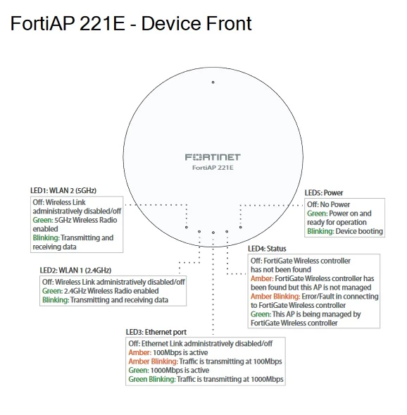

     If you are onsite or through someone on site, when this happens again check to see what the LEDs are doing.  If admin login is enabled on the APs, log into their GUI and check the status/wireless settings.

    Leds are all green, fortiAP status is OK. But any device is able to connect. When i try, it says password is wrong (Is not).
