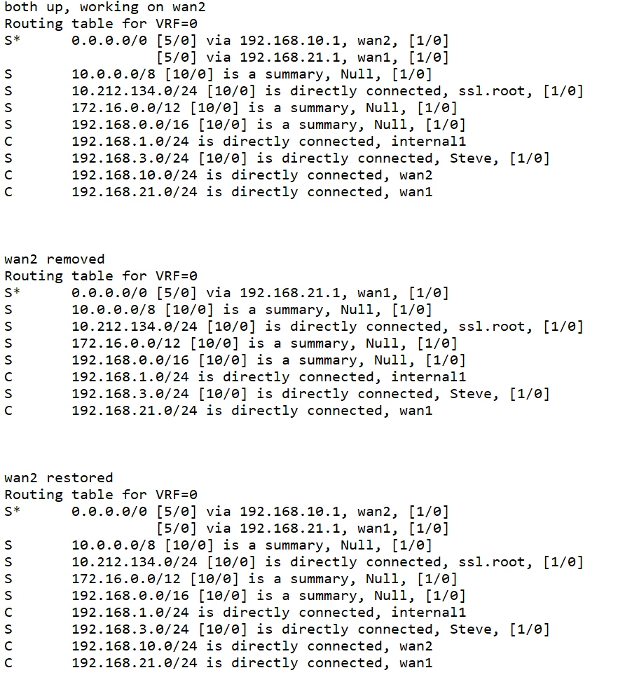

Either way should work. Share us the first part of "get router info routing-table all" that includes the default routes, when 1) both are up and working on wan2, and 2) wan2 was removed, then 3) after wan2 is restored.

Here it is.  Weird thing is [both up, working on wan2] and [wan2 restored] look the same, but when [wan2 restored] and I go whatismyipaddress.com I still see the wan1 IP.
Routing table for VRF=0
S*      0.0.0.0/0 [5/0] via 192.168.10.1, wan2, [1/0]
                  [5/0] via 192.168.21.1, wan1, [1/0]
S       10.0.0.0/8 [10/0] is a summary, Null, [1/0]
S       10.212.134.0/24 [10/0] is directly connected, ssl.root, [1/0]
S       172.16.0.0/12 [10/0] is a summary, Null, [1/0]
S       192.168.0.0/16 [10/0] is a summary, Null, [1/0]
C       192.168.1.0/24 is directly connected, internal1
S       192.168.3.0/24 [10/0] is directly connected, Steve, [1/0]
C       192.168.10.0/24 is directly connected, wan2
C       192.168.21.0/24 is directly connected, wan1
wan2 removed
S*      0.0.0.0/0 [5/0] via 192.168.21.1, wan1, [1/0]
wan2 restored
wan2 removed
wan2 restored

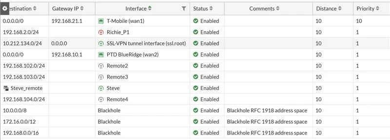

sjoshi
December 3, 2024
please make the priority of wan1 higher than wan2 and make the AD value same
Thanks, Salon
rfs3pa
rfs3paAuthor
December 3, 2024
No change.  No matter which one has the higher priority, it goes through wan1 whenever it is connected.
It shows wan2 with a * but I get public IP from wan1
