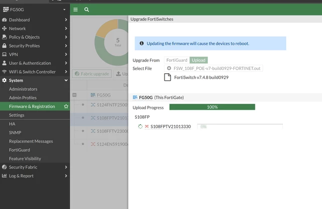

Failing to upgade a 108F-POE from 7.0.5 to 7.4.8
I am trying to upgrade the firmware of a 108F-POE switch from 7.0.5 to 7.4.8. In Fortigate interface, I can upload the firmware image, but the upgrade process does not start. Any idea what might be wrong? I tried other firmware versions as well (e.g 7.2) but no success

Hi Rouzbeha,
Pls review the below doc and see if this helps.
https://docs.fortinet.com/document/fortiswitch/7.4.5/fortilink-guide/801184/viewing-and-upgrading-the-fortiswitch-firmware-version
Try to execute the command in FortiGate and try again.
config switch-controller global
set https-image-push enable
