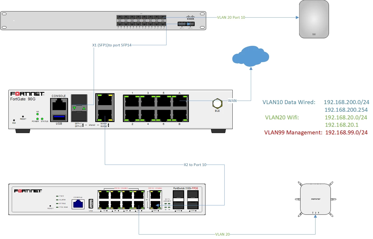

Hi all,
I need some help configuring a fortigate 90G Meraki switch with APs on interface x1 and a FortiSwitch interface x2 with an AP.
I got the Meraki side working by using manual mode on the x1 interface directly to the Meraki and using a trunk (I'm not sure if this is correct), but I'm stuck getting the FortiSwitch and AP working. I configured the dedicated FortiSwitch interface on port x2, and although the interface is showing as online, the status is still down.
The switch is also offline, even though I can access it directly.
I'm not sure if I'm on the right path with my current configuration, but any help would be greatly appreciated.

Hello
Remove X1 from FortiLink interface. Leave only X2 in it.
AEK
