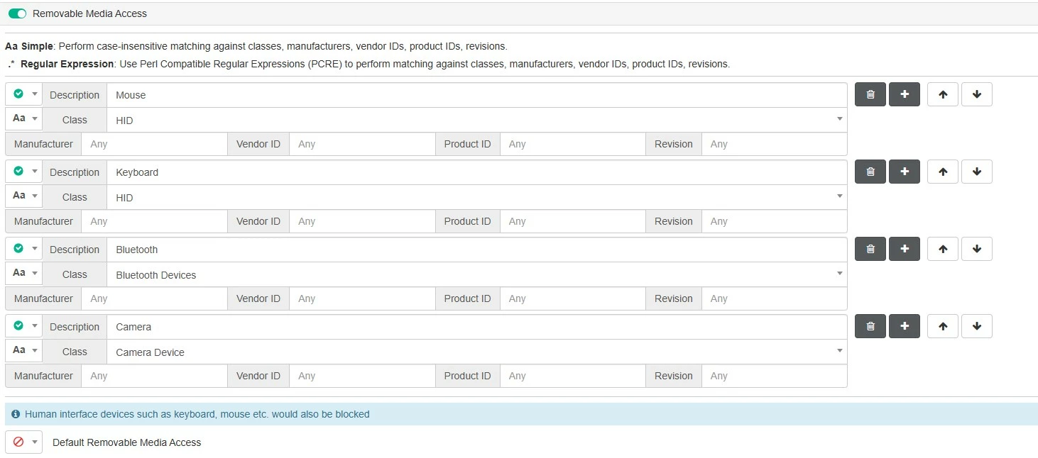

Since I configured this feature in EMS, it has been working perfectly, blocking usb devices while only allowing certain devices, especially Keyboard and mouse. However, my manager attached a USB dongle/device to a computer apart of target group/profile, and it is blocked by the USB policy. He instructed to disable the "Removable Media Access" feature on LAN until this ethernet-usb can be allowed on computers. I really don't want to keep this off for too long. Don't know why that instruction, but hey, following orders, at least my name won't be called for any issues.
Can you show me to allow this device in Endpoint Profiles -> Malware Protection -> "profilepcs" -> Removable Media Access?
Kindly see image below/attached showing my current configuration:

Open your device manager. When you plug the device it will add a new device in the device tree. Search inside that new device for its class name, then add this class to your EMS device manager as an allowed class. It should fix your issue.

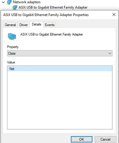

Hi AEK,
It has been a while. Happy new year to you and the team.
Please see screenshot below. Let me know if I am at the correct place.
Add NET as the class name in a new row?

February 19, 2025
Yes I think it should be that one. Just write "Net" in the "Class" field and hope it will work.
