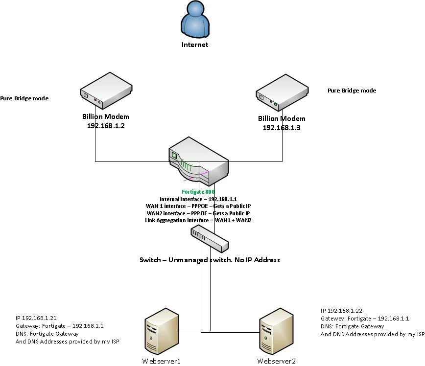

    Contributor III
    August 21, 2010
    Here is my proposed setup. Please note it is not setup at the moment as I need to call the cabler for deploying the 2nd telephone line. However, I thought it would be good to keep the architecture and plan ready. Can you please advise if this setup will work and ultimately help us achieve what we are after? The 2 links are from the same ISP. 1st link 24 Mbps Down and 1 Mbps Up 2nd link 24 Mbps Down and 1 Mbps Up Regards,
    Maik
    August 21, 2010
    1. Link aggregation interfaces do not work on PPoE interfaces 2. Link aggregation might be the wrong thing for your wan setup at all what is your goal? do you want to load balance your internal -> external traffic over the two wan lines? simple routing with ECMP might be the way. external -> internal (VIP' s) is a bit more tricky since you probably have two different public IP ranges with your two ISP' s. how you announce what route your clients should use?
    Contributor III
    August 21, 2010
    Hi Maik, Thanks for your reply. My goal is to get more speed so that end users can connect to my website without any delays and get a better experience in terms of speed. Regarding ISP: The internet connections that I have are from the same ISP. If you suggest link aggregation might not be what I am looking for, can you please suggest for my website what is the best method of making use of 2 internet links with the fortigate? Regards,
