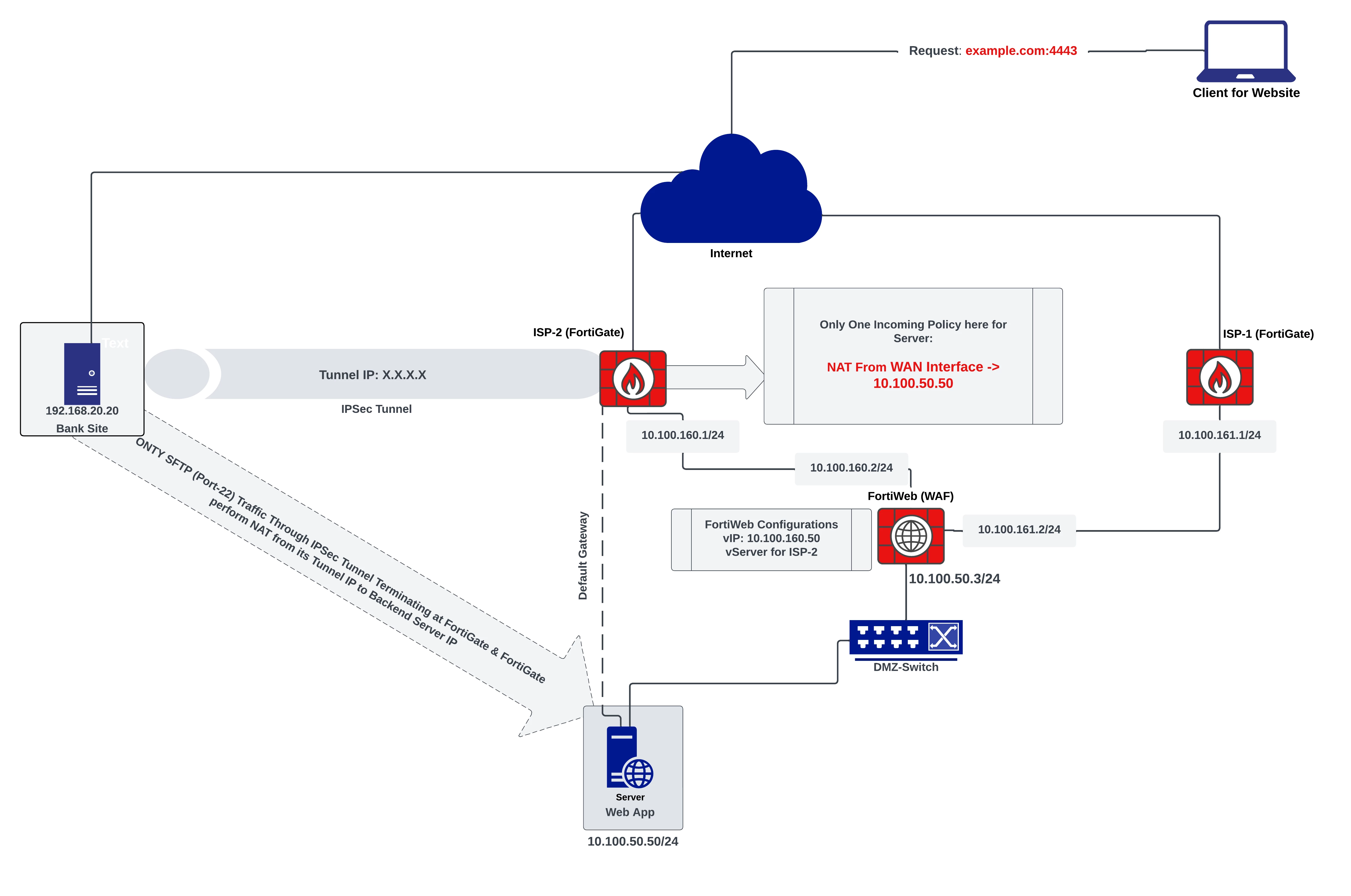

I think I need to clarify the scenario more. We are deploying a FortiWeb and migrating a production server behind the WAF. Firstly, we have two different gateways (Two ISP Connections, each with a FortiGate FW). For that, we have created two vServers on FortiWeb with two different Virtual IPs for each ISP connection. For routing, we used PBR (Policy-Based Routing) to route the traffic to its corresponding ISP FW.
Now, the main issue is that we have an IP-Sec tunnel on one of our ISP Connections (FortiGate FW), in which the same Web Server is configured to connect to a remote side server for SFTP Connections. Note that our IP-Sec tunnel is terminated at the FortiGate end, and the firewall performs NAT using an existing NAT policy that directs that traffic to the backend server.
If we migrate services behind FortiWeb, we have to change the NAT Policy on the FortiGate FW by changing the destination from the actual server IP "10.100.50.50" to VIP "10.100.160.50". In this scenario, all the services, including HTTP/HTTPS traffic (coming from website clients) and SFTP Traffic (coming from the tunnel), will terminate at FortiWeb. However, FortiWeb only receives HTTP/HTTPS traffic and drops all other traffic. This situation disrupts and drops our IP-Sec Tunnel traffic at FortiWeb.
To clarify the scenario more, I have created a network diagram pasted below. Please review it and propose a solution that includes which configurations should be changed on FortiGate to segregate the traffic coming from the same public IP address., or in FortiWeb to bypass the SFTP Traffic without Policy Checking towards its BackEndServer. We need to perform double NAT or another method to route SFTP traffic to the actual server IP '10.100.50.50' and HTTP/HTTPS traffic to VIP "10.100.160.50". Remember, we are in a production environment.

I hope now I understood better and I think you have two possible solutions:
  1. Enable firewall at FWB level (feature visibility) and allow port 22
  2. Or forward only HTTP(S) traffic to the VIP (using DNAT port forwarding 80->80 and 443->443), while continue to access server's port 22 directly to the BE server's IP through the firewall (not through the FWB). I always use this solution in my integrations because I think it is more logical and cleanest design (in my opinion)
