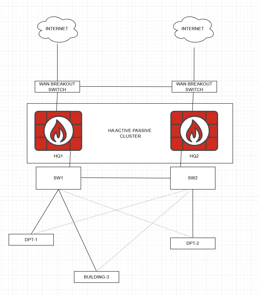

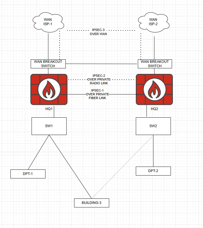

Hi All,
I'm working on a business continuity project.
My goal is to have a 2nd datacenter where I replicate the Virtual Machines.
I'm trying to find the best solution for the network.
AS IS:
Right now all the buildings and department are connected to the HQ1.
The datacenter is in HQ1.
DPT-1 is phisically located next to HQ1.
DPT-2 is phisically located next to HQ2.
Building-3 is phisically separated from HQ1 and HQ1.
All the routing is done by Fortigate cluster in HQ1
HQ2 at the moment has only a switch that connect that part of the network to HQ1 where the datacenter is located. The link is with a single private fiber link that pass under a street.
All the vlan are spreaded across the network and divided by function not by department (es client vlan, server vlan etc)
TO BE:
I have to avoid interruption caused by fiber issues.
We'll replace the current fortigates in HQ-1 with a cluster of 121G.
We'll add a cluster of 121G in HQ2.
We'll add a new ISP link in HQ2.
We can add radio link for fiber redundancy (link in blue color in the diagram)
Now the question is: Is it better to have a single cluster of 4 fortigates or is it better to split it into 2 clusters and manage HQ1 as a standalone network with his vlans and the same for HQ2?
If the second solution is better how can i manage BUILDING-3 network redundancy?
I attach the solution 1 and solution 2 diagrams
Thanks.
Regards.
solution 1solution 1
solution 2solution 2

Do you require all the vlans in HQ1, HQ2 and Building3 to be layer-2 of eachother, or could they all be routed?  Building 3 is also supposed to be layer-2?
LorenzoManfrin
Explorer
October 8, 2025
Right now vlan are spreaded in layer 2 across the buildings even for the Bulding-3, but it's just for convenience, there isn't a real need.
For the new design. Vlans can be routed, it would mean more work but it's not a problem.
