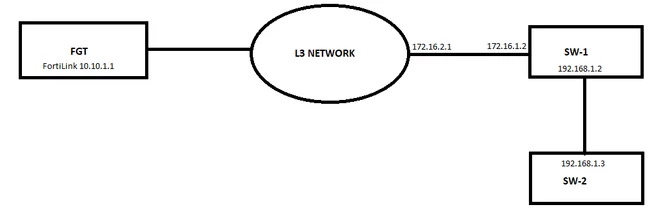

Hi team,
I have some doubts about integrating remote FortiSwitches to FortiGate. I have read this document, but I still have doubts:
https://docs.fortinet.com/document/fortiswitch/7.6.3/fortilink-guide/801182/fortilink-mode-over-a-layer-3-network
This is my topology:
SW-1 and SW-2 are not a stack, they are independent switches. SW-1 and SW-2 internal IPs (192.168.1.x) can reach FGT FortiLink IP 10.10.1.1. I will use in-band management for the FortiSwitches (the internal IPs).
On the FortiSwitch, will these be the commands for SW-1?
config switch-controller global
  set ac-discovery-type static
  set source-ip 192.168.1.2                  <<<< in-band internal IP?
  config ac-list
      set ipv4-address 10.10.1.1            <<<< FortiLink IP in FortiGate?
Am I correct? In FortiGate do I only need to configure FortiLink interface with IP 10.10.1.1 and DHCP server disabled?
For SW-2, will the commands be the same just changing source-ip?
There is the "In-band management section" followed by "To configure a FortiSwitch unit to operate in a layer-3 network". It says:
If you configure static discovery, you need to create a static inter-switch link (ISL) trunk and then enable or disable automatic VLAN configuration on the manually created (static) ISL trunk.
Why do I need a ISL trunk? Does it apply to my topology?
Please help, I know FortiGates but I am new on FortiSwitches.
PS: I will have FortiManager as well. In this case I don't know if the FortiSwitches will have to be integrated in FortiGate, and then FortiGate integrated in FortiManager. Or the FortiSwitches will be managed directly with FortiManager without FortiGate.
Regards,
Julián

Hello fjulianom,
I found this solution. Can you tell me if it helps, please?
The configuration commands for `sw-1` are correct, and similar commands should be used for `sw-2` with the appropriate source IP. On FortiGate, configuring the FortiLink interface with IP 10.10.1.1 and disabling the DHCP server is sufficient. An ISL trunk is not necessary for your topology unless `sw-1` and `sw-2` need to communicate directly. FortiSwitches can be managed directly by FortiManager or through FortiGate, depending on your management strategy.
