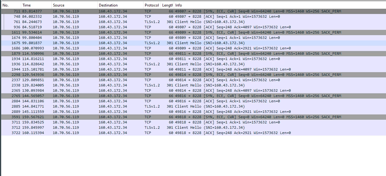

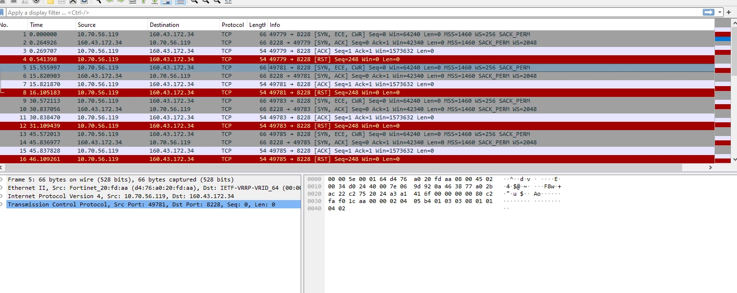

Thanks. I've captured the packet below for reference.
Who causes the RST from the packet below? source or destination?
Thanks
srajeswaran
March 3, 2024
10.70.56.119, is sending the RST (source). Also, the connection is reset before any certificate exchange, so the issue may not be related to certificate. Can you confirm from which interface this capture is taken? The interface between Fortigate and Internet or Fortigate and LAN? You may take similar capture from Internal interface and external interface to confirm the behavior.
DashingCodyRhodes
Explorer
March 3, 2024
That one is the closest to the destination, after that its the Bloomberg router at the prem (colocated).
I have a packet capture closest to the source as well
