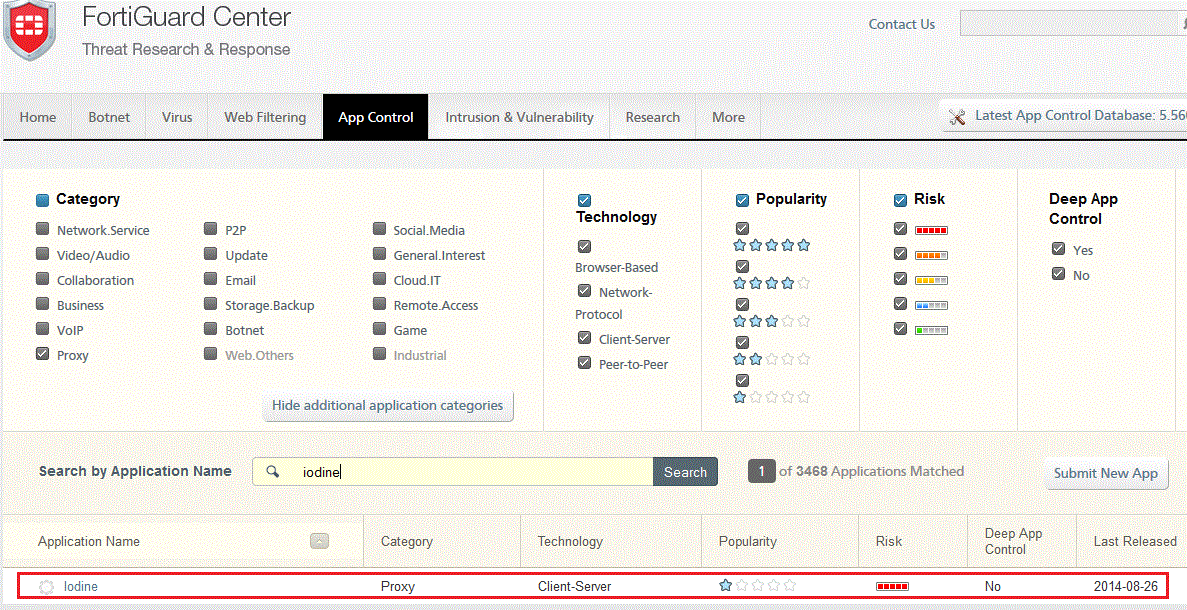

    Iodine is listed in app control as a proxy; I would imagine you can tailor an app sensor to block proxies over DNS traffic.

    I regularily use an AppControl sensor with these DNS misusers: DNS_DNS2TCP DNS_Dynamic.Update DNS_Request.ANY.Record DNS_Zone.Transfer TCP.Over.DNS

    AppControl is based on the IPS engine. Any reason why you don' t want to use it? CPU load won' t be affected much.
