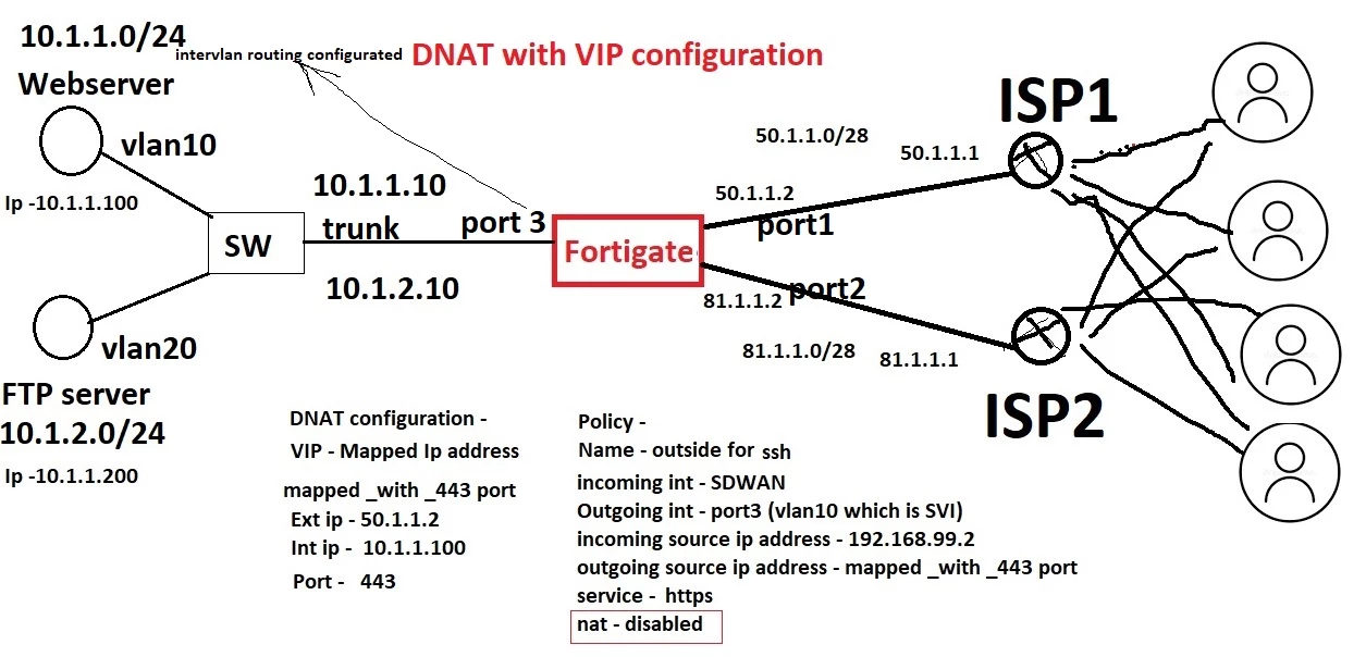

Hi everyone,
I want to know should I diable nat if we have configured DNAT with VIP in Fortigate Firewall.
Reason - Let me know about it when should we enable or diable NAT.
FYI - If I enabled nat then it is working if it is disabled then it is not working.
Please find the attached digaram what I am doing in my oranization.

Hi @Umesh
When you enable NAT, this means that SNAT is also taking place and this usually is the outgoing interface of FGT. This works because this is in the same subnet as the destination host you are trying to reach.
When you disable NAT in policy, original address would be used and I believe the destination host does not have a route to send traffic back to FGT.
Thank you.
Shahan
Toshi_Esumi
October 14, 2022
In other words, 10.1.1.400's default route is not pointing to 10.1.1.10, the FGT.
