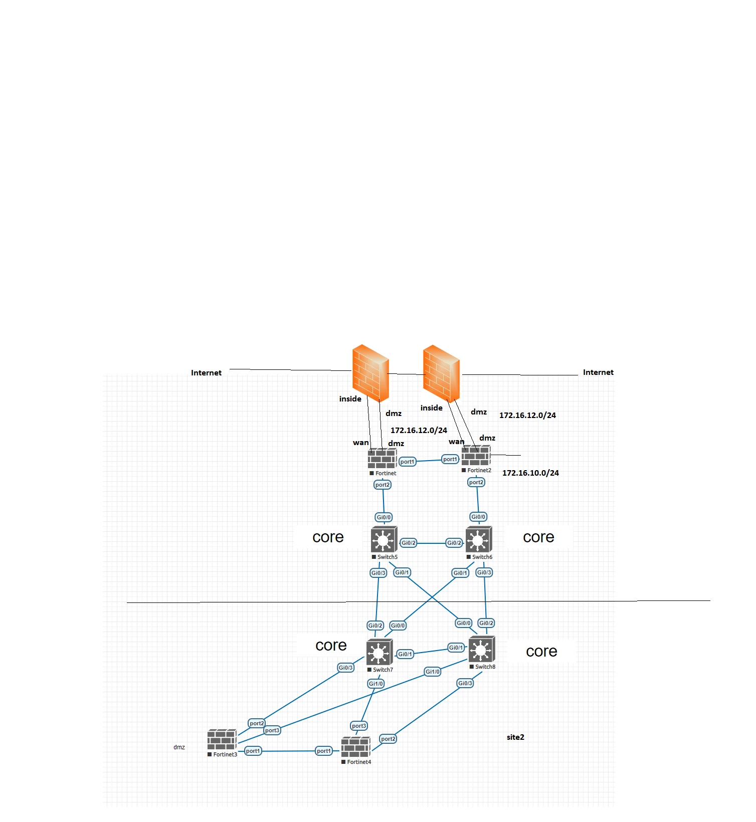

I have the below topology , I want to migrate all dmz and dc networks to site 2 .
In the site 1 there are two firewalls ASA and FORTIGATE .The perimeter firewall is asa . The Dmz network is 172.16.12.0/24 on ASA and in the FG it is 172.16.10.0/24 . There is A DMZ vdom in fortigate .
currently SITE 1 FG is Translating 172.16.12.0 /24 to 172.16.10.0/24 (Dmz serverIP'S)
Stage 1 : I want to move DMZ vdom from the SITE 1 -FG to and site -2 FG
Stage 2 : Remove ASA
How can I achieve this , any pros and cons

You have to share more details on the design to tell you more
1> IP addressing scheme/ VLAN details.
2> Are the same VLAN's are already available in Site2 , as from the diagram it seems you can have same vlans extended being connected in same cores.
3> You can plan to migrate based on vlans/subnets, By configuring a new gateway/interface IP on Fortigate and then changing the routes.

site1 the actual dmz ip which is natted with the external ip addresses are 172.16.12.0/24
on fortigate it is 172.16.10.0/24 , so  I am translating (one to one ) 172.16.12.0/24 to 172.16.10.0/24
For example on ASA , 172.16.12.50 natted to 1.1.1.1
and on fortigate it is nated again to 172.16.10.50
Between site 1 and 2 are l3 connectivity .
