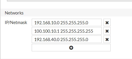

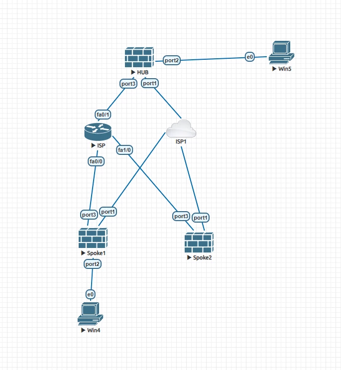

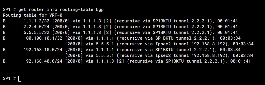

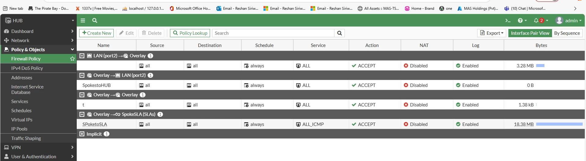

i setup this hub site with diaup ipsec option with igbp my issue spoke1 to spoke 2 not ping
But Branch 1 not showing in routing table branch 2 subnet.pngHUB side bgp network advertise branch 2 network.pngHUB Side Policy.pngtopology.png

The provided routing table in the first screenshot is from spoke 'SP1'?

 Where x.x.x.x is the WAN IP of SP1 and y.y.y.y is the WAN IP of SP2. Make sure that there are no restrictions between SP1 and SP2 over port3 and port1(shortcut tunnel between SP1 with port3 and SP2 with port1).

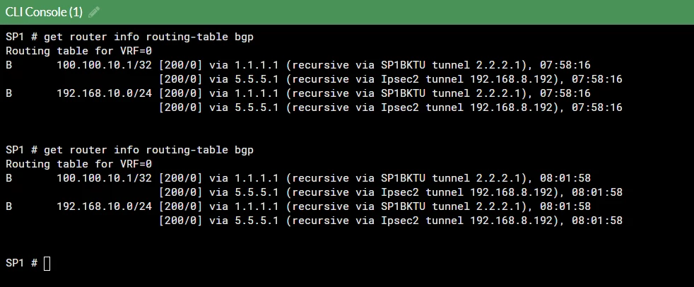

Yes after enter above config my issue now sorted.
Spoke 1 to Spoke 2 ping successful.
