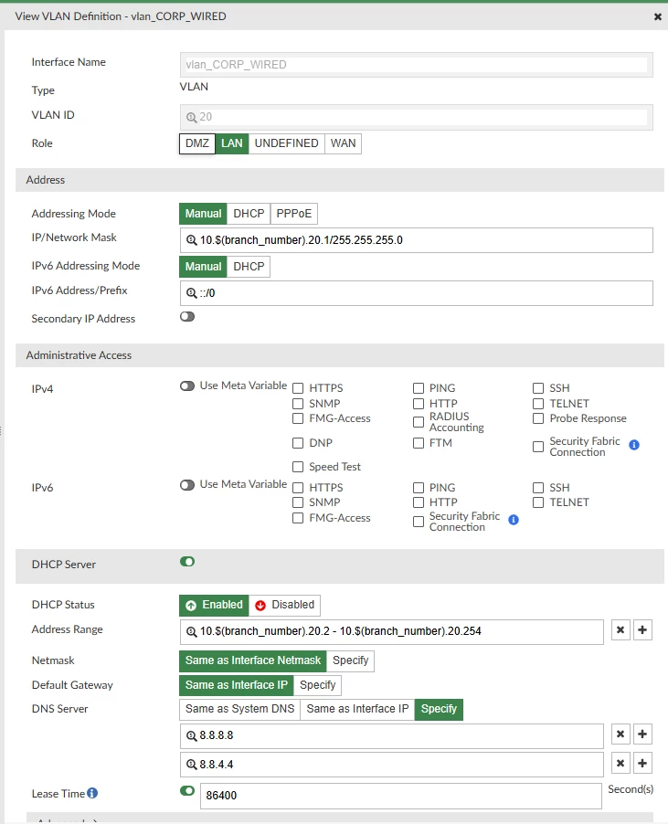

Hi,
FortiManager Cloud - v7.4.7 build6767
I am trying to configure DHCP on one of our FortiSwitch VLANs. The VLAN uses a variable. The basic VLAN itself is fine and has been applied to a switch template and pushed to our FortiGates.
variable = branch_number
VLAN IP Address =  10.${branch_number}.20.1/255.255.255.0

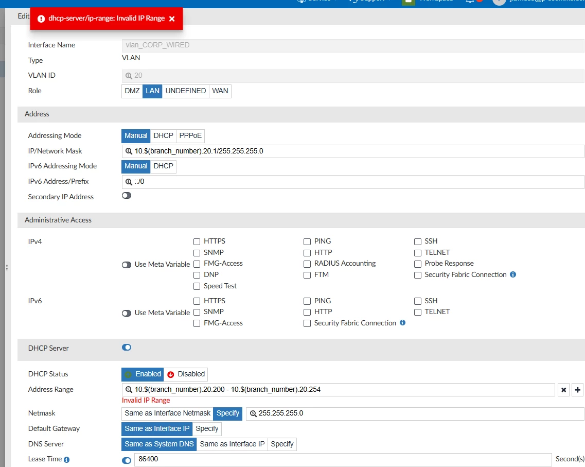

When trying to enable the DHCP server on the VLAN, I am unable to even close the Edit VLAN Definition page on the GUI. It comes up with the error dhcp-server/ip-range: Invalid IP Range.
If I remove the variable, it does accept the config and let me click the OK button.
Its the same if I set the Netmask to 'Same as Interface Netmask'
Thanks in advance!

Hi,
Just a quick update. Fortinet support have confirmed this is a bug in 7.4.7 ( Issue # 1156793) and will be fixed in 7.4.8. I'm unable to update to 7.4.8 because as of writing its unavailable to install on FortiManager Cloud. Support will be updating our instance later in the week (10th Oct 25).
They gave me a workaround - Set a valid IP Range without using metavariables first, then replace with metavariables, but I was unable to get it to work when I tried this. For now I'm just going to wait for the upgrade.

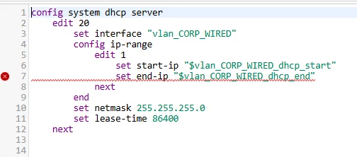

Some further troubleshooting I've done. I've attempted to get round this by using a CLI Provisioning Template. I have tried a number of different CLI scripts but they all fail with the same error on the same line - the set end-ip line
Error Message -
Copy device global objects
Post vdom failed:
error ip-range end-ip- 1 $vlan_CORP_WIRED_dhcp_end:-999 - invalid value - [line 8] > next [attribute "end-ip" check error - runtime error -999: invalid ip - prop[end-ip]: ip4class($vlan_CORP_WIRED_dhcp_end) invalid ip address]
Copy objects for vdom root
Some variations of the script, one using my original variable, one using a fully defined pair of IP's
config system dhcp server
edit 20
set interface "vlan_CORP_Wired"
config ip-range
set start-ip "10.${branch_number}.20.200"
set end-ip "10.${branch_number}.20.254"
set netmask 255.255.255.0
set lease-time 86400
edit 20
set interface "vlan_CORP_WIRED"
config ip-range
set start-ip "$vlan_CORP_WIRED_dhcp_start"
set end-ip "$vlan_CORP_WIRED_dhcp_end"

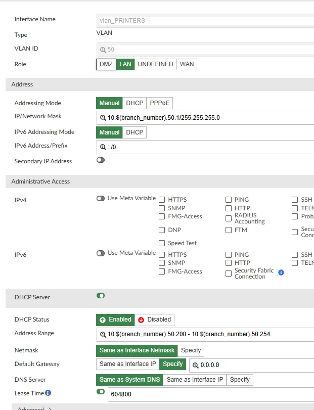

I have had this exact config working before on another FortiManger Cloud. See screenshot below, so I'm not sure what is different. The FortiManager Cloud below is on v7.4.6. The one I am having this issue with is v7.4.7. I tested by creating a new VLAN (vlan_PRINTERS). I was able to complete the setup without any issues, so it looks to be something up with 7.4.7.
7.4.7 is still the current recommended version. The next versions available from the Cloud dahboard are 7.6.3 & 7.6.4 (GA.F). If I downgrade to 7.4.6, this will involve a factory reset, plus doesn't answer the question as to whether this issue will crop up again when we inevitably have to upgrade. There is a 7.4.8 available to download from the Fortinet, but this is not showing as available on the Cloud dashboard....
Both screen shots from Lab FortiManager running 7.4.6. VLAN 50 created today without issues...

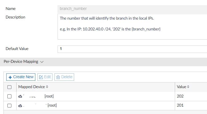

ebilcari
October 7, 2025
Have you checked if the metadata variable is mapped correctly as shown here?

_panda_
_panda_Author
Visitor III
October 7, 2025
Hi ebilcari,
I have mapped them under Policy & Objects > Advanced. This mapping does work for the IP address of the VLAN.
