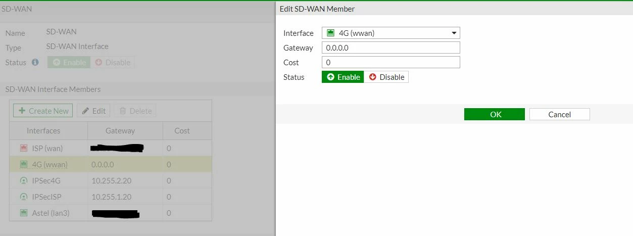

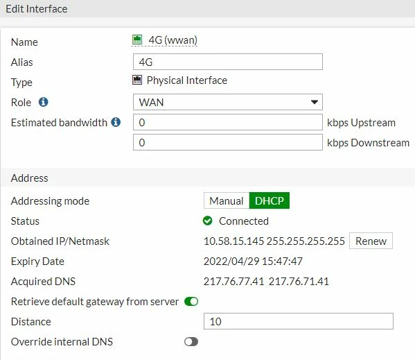

FWF30E-3G4G (6.2.10)  is using onboard LTE modem with SDWAN. It works only with direct routes, and doesn't work  with static route sdwan--> 0.0.0.0. LTE gets dhcp address with /32 mask - so there is no any gateway... If I downgrade it to 6.2.9 - everything is fine, LTE gets /30 address with normal gateway. Asking here to see if anybody recently had this issue. Thanks!

Nevermind, found the bug 745856;
Resolved In 7.0.6, 7.2.0. Waiting for a fix in 6.4.10.
No fix in 6.2.10 (out of Eng. Support).

Alex! Thank you very much! Workaround is to add RANDOM hahaha gateway to wwan and priority at 100. ))) Awesome
