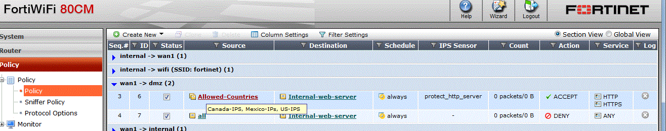

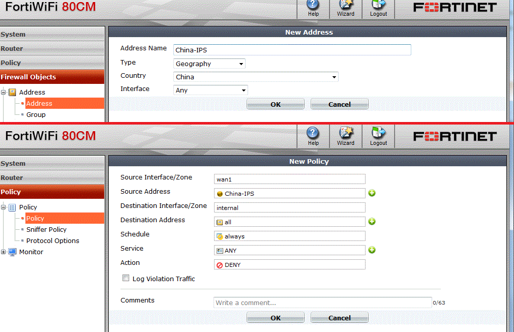

I' m trying to block specific regions of the world from accessing our public services. Particularly, I' m testing access from China using http://www.websitepulse.com/help/testtools.china-test.html -- so far I added a policy that denies all sources orginating from China. That policy sits before our allow policy for http access to our internal web server. That metod doesn' t seem to work. I have to lock down our allow policy to only allow like US/Canada/Mexico sources in order for the access from China to be restricted. I was hoping adding a policy to deny all international source addresses before our allow policy would do the trick - is that not doable?

    You did not specify which firmware your fgt is running on, so this is for 4.0 MR3.... 1. Create a firewall object type Geography for China. 2. Create a fw policy from WAN ->Internal, using the firewall object you just created as the source address. Set the Action to block. 3. Move this rule above any other existing WAN->Internal fw rule you may have.

    Thanks for the input guys. Thing is, I already have the deny all for China at the top of our WAN1->Internal list. It' s not working though.. Running v5 GA Patch 5 firmware. Again, if I lock down the allow policies more it works as expected. I' ve actaully got a Group created for a slew of countries that we simply don' t want accessing our services. No reason for them too so we' d like to take the proactive approach and just deny everything matched regardless of the allow policies below it. I' ve tried adding the international deny policy as " any/any" - same result. I hadn' t tried slapping it on internal -> WAN1 though. I' ll see what happens. This is my first go with Fortigate' s and having coming from Cisco I just figured a Deny all at the beginning would stop all matches through out the rest of the policy list. Maybe that' s not the case though. EDIT: Tried applying the Deny rule to the Internatinal group on internal -> WAN1 -- same results
