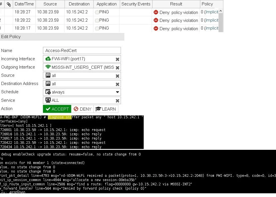

Hello Team
I have two sub-interfaces one connected  oneto a Wifi Network 10.15.242.X ,and other in a wired network 10.38.X.X I have made an specific rule to permit the traficc to do a ping between networks.
And not match in any rule and the traffic is denied by the implicit rule all the time ...
I have made a Sniffer and a trace in the forti ( see images attached) ,and i see in the tcpdump how the trafffic reach the default gateway in the fortigate 10.15.242.1. but not the PC conected in the IP 10.15.242.2 allways denied by policy 0
I have a Fortigate 1500D With firmware 5.4.4 Version
Any suggestion ? i am going crazy ..

Can you please supply the config of the interfaces involved (conf sys int)?

What we really need is the fwpolicy, Your screenshost conflicts with the interfaces names
MSSI-INT2  vrs INT_USER
Did you happen to  typo the wrong interface_name ? Also on the  diag sniffer  packet, a suggetsion
1: specify the interface name
2: use the  4   value to double check  ALL interface
e.g
diag sniffer packet  MSSI-INT2 " host 10.15.242.2 and icmp" 4
That would be better than "ANY" and you can look at the traffic from srcintf or dstintf .
So double firewall-policy and than routing.
just a tip ;)

I think the problem is de routing between VDOMs, the network 10.15.242.X is in the VDOM-Wifi and the 10.38.23.X is a network in the VDOM-Root
When a execute a ping from de VDOM wifi to the gateway 10.15.242.1 i can reach susccessfully. becasue is direcctly conected, but when i execute  a ping to 10.15.242.2 is when the ping fails.
However in both cases i can see the traffifc in the Diagnose  sniffer packet ...
