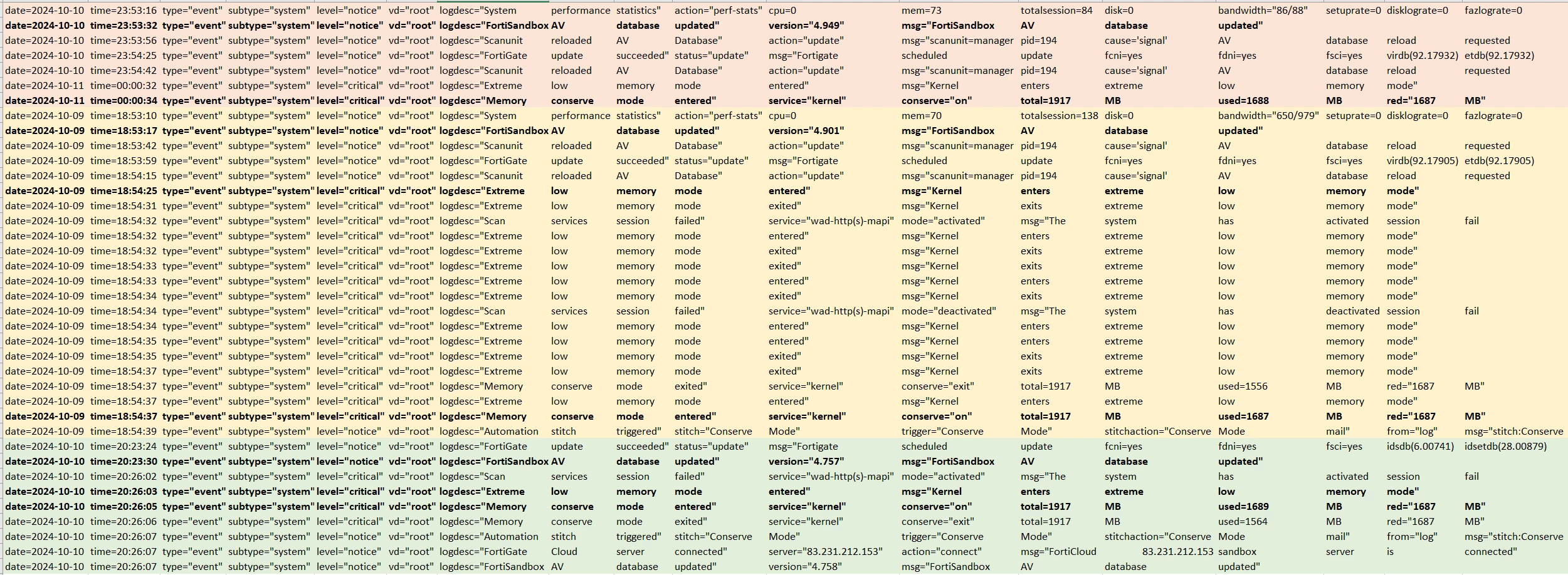

Hello, I have a Fortigate 60F @Home. I upgraded it to 7.4.5 last Sunday (a maintenance window is rare at my house). My principle is to wait for patch .4 before upgrading to a new level. I was hoping I would be safe with 7.4.5.
But now my Fortigate enters “Kernel enters memory conserve mode” every day.
Once I had to reboot and twice it came out on its own.
I agree with @NotMine, that this Fortinet should fix this as it is clearly a bug. Changing the configuration, especially by disabling or limiting IPS scanning, is not an option for a Firewall.
By the way, this would certainly not be the first time either. I have also experienced it with FTG 1200Ds. Turned out to be a bug in the IPS engine after a very long case.
jblyon
October 10, 2024
We're seeing the same thing happen on our 60Fs running 7.4.5. It enters conserve mode and then extreme low memory mode a few seconds later. This is immediately after a Fortiguard update occurs and the unit needs to reload the AV database. The unit will drop all connections until it is either rebooted or about 20 minutes pass. If you let the 20 minutes pass memory use drops right back down to the 66% that it's normally always at. There's no sign of any other memory leaks, it's sudden after an AV database reload following an update.
We have a ticket open, but Fortinet has not responded to it yet. In the meantime we've scheduled updates to occur outside business hours where it doesn't matter if a branch office drops offline for 20 minutes afterward. This has kept the units from dropping off during business hours.
Edit: Support replied trying to blame the fact that the unit was already at 66% memory use before the update process. I asked them to explain how an increase of at least 29% on 7.4.5 could be considered normal when on 7.2 and 6.4 memory use increases by only 1-2% during Fortiguard updates...
EME
Explorer III
October 11, 2024
Yes I can confirm. After a “FortiSandbox AV database updated” I get “Low Memory” and “conserve mode” messages. I have listed 3 of them:

Kudos to both of you, @jblyon and @EME, for narrowing down the potential cause!
We've replaced the unit in RMA, but the device is still entering the conserve mode.
I can substantiate your finding that FortiGuard update is causing this, because our device stopped responding yesterday around 1:30 PM, with FortiGuard updates scheduled daily at 1 PM. It was completely unresponsive, even thru the console connection.
Strangely enough, nothing in the crashlog about the conserve mode.

The "brave" journey stopped hard over the weekend... First it was looking good until the update of the FortiGuard and then one CPU spiked to 100% and stayed there. After that randomly it gave no connection or extremely slow responses for surfing. The WebGui was still accessible without any issues and no special things are logged. The other day it was that bad with the random responses that I had to reboot it. This solved the CPU spike after 15min delay of the reboot... updating a IDS/AV???? But then it started again after about 3-4h uptime to get random delay's in surfing or streaming. Sometimes no delay sometimes even to the point of not reachable.
I was watching a movie on Sunday and this was doing it right in the middle again. I then decided to go the short way even with the knowledge of loosing something but being up hopefully in short time again and downgraded it to 7.2.10. This release is actually working fine on my 61F so I gave it a try. The downgrade took some time but since then (klapp on wood) it's stable on the 60F. I think I would doo a factory reset and fresh config on the 7.2.x train.
Hard to see that Fortinet is rolling out such bad releases more and more and in the same time removing functions which where working on the 7.0 and 7.2 without any bigger issues on the "low-end" models if you stay in the spec's of small business amount of users.
Also as mentioned below why not put 2 or 4 gb extra of ram in it this will not make the whole unit much more expensive in terms of manufacturing, except the are buying the memory from apple...;-)
will post an update when I made the fresh config to get rid of the downgrade mess if it's stable now.
