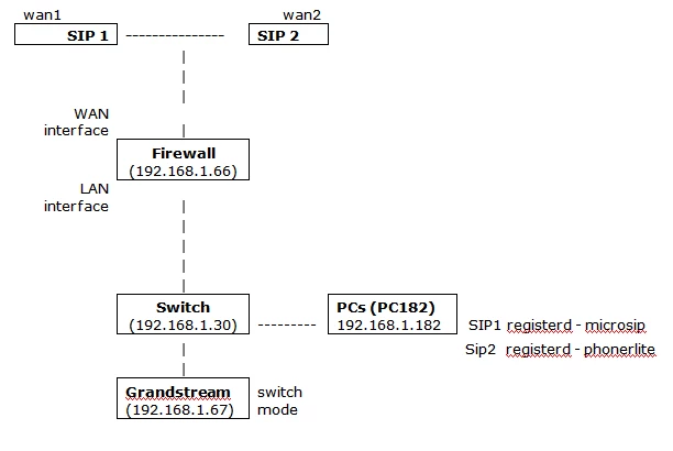

Hello everyone,
I’m encountering an issue while attempting to connect two SIP trunks with different VoIP providers in my Grandstream UCM 6301 using FortiGate firewall 80F. I’ve configured the SIP trunks individually, and each works fine when connected individually to the WAN port of Firewall too ( Added a Policy route to forward all traffic on this WAN port to LAN port ) . However, I was not able to make calling work when connecting both SIP trunks simultaneously.

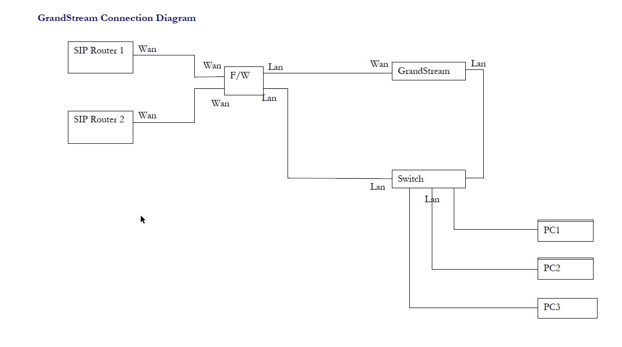

I have attached the Connection diagram of Firewall and Grandstream for 2 SIP case.

Update :
"I have done some changes in the configuration as mentioned below. After the changes
I am able to place outbound calls but no voice / audio can be heard when I Connect the Grandstream device to the Fortigate Firewall in Switch mode.
If I remove the grandstream device then I can place calls and also hear audio / voice.
What changes do i Have to make to be able to solve the Audio Issue ?"

Toshi_Esumi
April 11, 2024
I don't know how GrandStream would operate with two SIP trunks but FGT FW settings should be simple: need to allow all traffic from the GS toward the trunks and forward everything from the turnks to the public IP to the GS.
First, you need to figure out why the GS can't ping the pingable trunk address, by sniffing/flow debugging while you're sending ping packets from the GS. Are they sent out to those wan1/wan2 interfaces or dropped by the FGT?

AEK
April 11, 2024
Hi @R_007
I find it a bit strange that you enabled NAT on both GS and FG. I'm not certain about that and don't know if it is the cause of your issue but it seems to me more correct to NAT on FG only.

Toshi_Esumi
April 11, 2024
That's probably because @R_007 wants to route data traffic from those PCs directly through the FGT as in the diagram while voice traffic to the GS. Without NAT on the GS, probably the FGT wouldn't route voice traffic back to the GS. But I'm not sure what exactly GS's "NAT" would do for voice traffic.
But that was my next question after figuring out why pinging from the GS toward the SIP trunks doesn't work.
