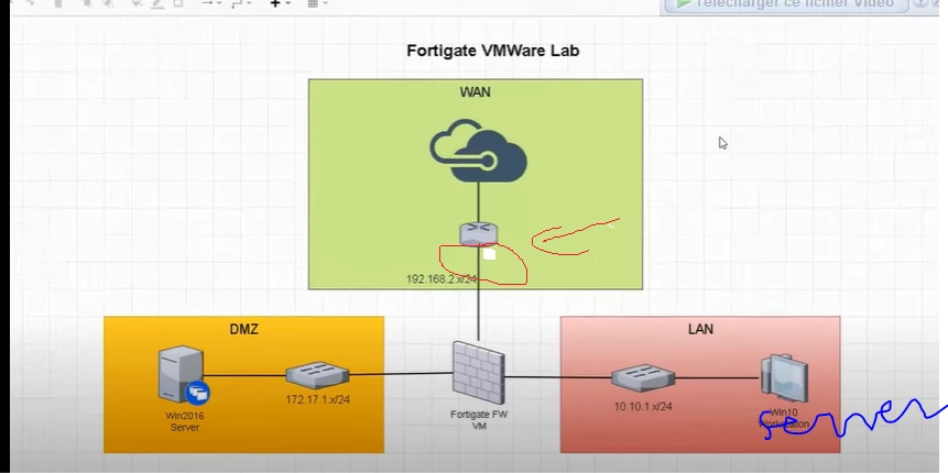

Can you advice me ?
how to let the router access to the server i will send the logs of the router to the elastic server what i do in fortigate ? what i will configure in fortigate 294766800_562538495424875_9082956238751245529_n (1).png

Hi,
If you are managing the router and if you have correct routing from router to your internal server, you just need firewall policy to allow traffic from ext_interface to int_interface. If router doesn't have routing info about your server, then VIP on FortiGate, external IP will be IP from 192.168.2.0/24 (probably IP of FortiGate's external interface) and forward it to internal IP of the server.
https://community.fortinet.com/t5/FortiGate/Technical-Tip-Virtual-IP-VIP-port-forwarding-configuration/ta-p/198143

@akrist how can i delete a VIP config by cli because i do an error VIP and i can't now access to fortigate via gui
akristof
August 4, 2022
Hi,
Connect to different interface (probably from different PC) or via console.
